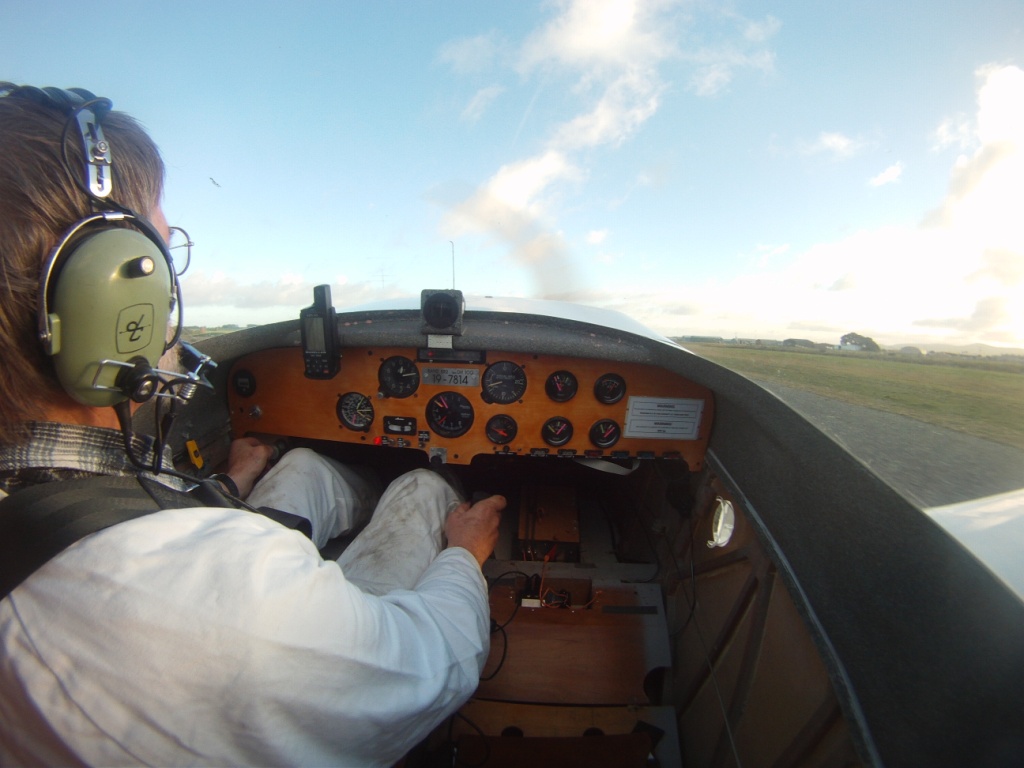

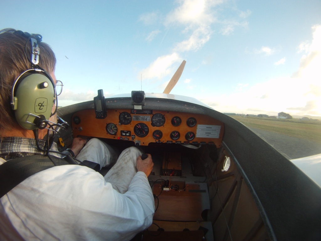

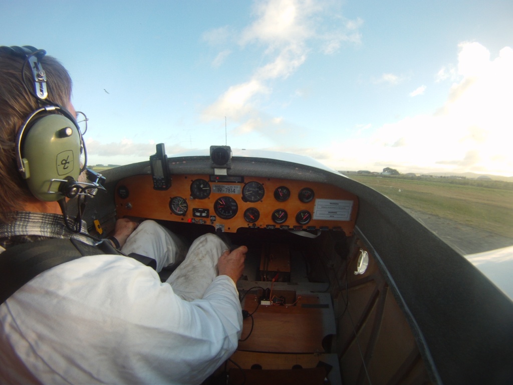

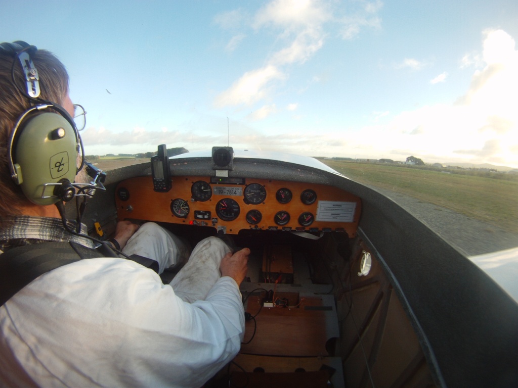

Then we went for some tail up runs and found a bit of a problem .... every time (almost) that I lifted the tail, the engine cut out. See the attached sequence of photos taken by a camera we setup to take photos every 5 seconds for just this sort of issue .... the resolution is a bit fuzzy to reduce the size, but on the originals you can read the instruments fairly well too ....
From the indications on the mixture indicator (the row of LEDs top centre of the panel (lean =red to the left, rich orange to the right)) the mixture goes lean as the tail comes up and then the engine stops, all in less than 15 seconds ...... this is just one of several sequences we recorded all much the same ...

28581969_GOPR0034stickinitalforwardmovement.thumb.JPG.d73942b9c97e8db132c93c2495ca06c6.JPG
1275727121_GOPR058610secondsafterinitalforwardstick.thumb.jpg.dbc566c0f11aaab5809f95df9d199acb.jpg
1480446239_GOPR058715secondsafterinitailstickforward....thumb.jpg.419cad4c1dd2868a03c9cde8e5979f73.jpg
