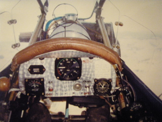

Guest Maj Millard Posted July 2, 2011 Posted July 2, 2011 BB, I have actually built one or two in the past for various projects, pretty much a case of keep it simple !.....There's one there somewhere on my old biplane panel...............................................Maj...
Bubbleboy Posted July 2, 2011 Author Posted July 2, 2011 BB, I have actually built one or two in the past for various projects, pretty much a case of keep it simple !.....There's one there somewhere on my old biplane panel...............................................Maj...[ATTACH=full]14311[/ATTACH] Does the tube need to be glass or can it be plastic etc? Scotty
