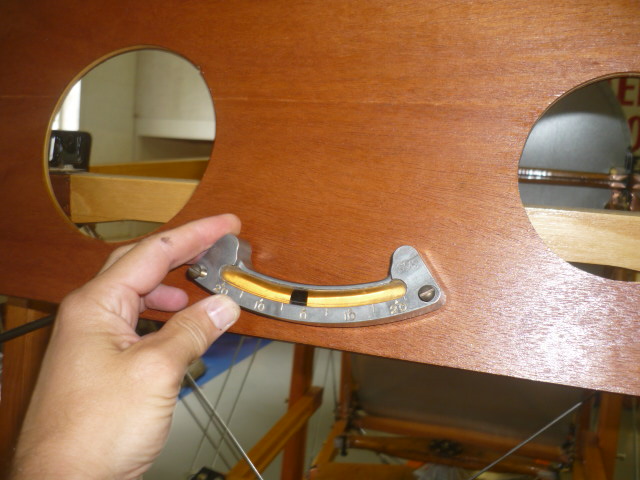

Bubbleboy Posted July 7, 2011 Author Posted July 7, 2011 This is something like I am looking for but maybe not as big? In brass would look lovely! Surely there is someone out there who sells them for the replica WW1 aircraft that are out there? I pulled the front cover off one I have here and its not a just a glass tube. There is an additional section at the top that was used to fill it I think and now serves the purpose of hiding the air bubble...Scotty

Bubbleboy Posted July 7, 2011 Author Posted July 7, 2011 Quote You can't just use a spirit level. I think the one you have looks pretty good. There's got to be a way to get a brass colouring on that metal. Since brass is an alloy, I don't think you can electroplate it, but I think there may be some sort of paint type product that would put a brass patina on the metal.OME Hi Mark...the semi circle example above that the guy is holding is what im looking for. It was an example I found on the web. Wag aero has a similar one. Scotty

facthunter Posted July 8, 2011 Posted July 8, 2011 A few points in passing.. BB, flying with a spirit level would be difficult. Those things are far too sensitive. ........ There has to be an airspace to allow for expansion in the tube. Don't forget that the ball can't be a close fit in the tube or the fluid would take too long to get past it, and it would be overdamped. The weighted ball is only a pendulum in effect. It is measuring SKID or SLIP. It doesn't measure Bank in any way. Cleaning brass... Mostly done with polishing. Brass is an alloy of zinc and copper. It will nickel plate easily, and nickel was the most common plating material prior to 1930, when Chromium became more common. Nickel looks lovely. Turn and Bank........ The turn needle is a different matter. Being driven? by a gyroscope and responding/indicating rate of turn it does indirectly give you a measure of bank, insomuch as the more bank the larger the rate of turn. ( Speed being constant). Nev
