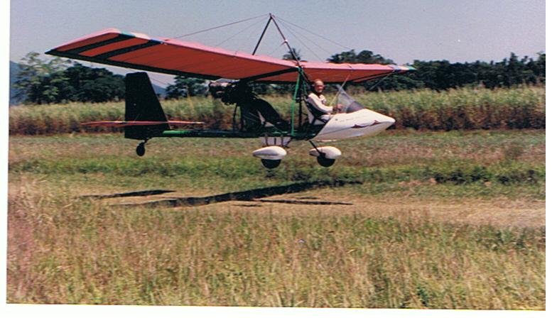

Lizzard Posted July 27, 2011 Posted July 27, 2011 Hi all, I just found this forum .. great stuff everybody! I come from the roots where if you didnt build your own trike ... you shouldnt fly. Pioneered a few hangliding sites and still get grubby hands ..54 now I see that commercial ,ga influences, and blame games (insurances)have allowed many non mechanically minded people to fly with relative saftey. I dont see engine off spot landing comps I do see that it's something that MUST be practiced safely. Of note is that trikes are now very over equiped and over priced for a machine that basicaly flies in fun circles ..whats the hurry? The very best trike I ever flew was a moyes mars 170 and a 277 rotax..slow but the handling! I have a few trikes, all of which I built, and wings wizzard 2 pegasus airborne shark(hanglider) My bases are tig welded stainless steel brackets with 6061 t6 tube sections . very light and impossible to make commercially. Sharing the little bits we have learned enhances our experience and makes everybody safer. Still reading.......... here's a video of one of my builds Lindsay 2

Lizzard Posted July 27, 2011 Author Posted July 27, 2011 The basic of the skybike A friction drive from the rear wheel drives a chain which drives a 3;1 90 deg drive the rear brake becomes the throttle. A hard compound tyre was vital ... you can hear the drive slip just after the flyby . I only did a few hours on it ..but it really needs a stack of money thrown at it to get it refined . I would have used a lighter trail bike but needed the excess power (110 hp) so that i could ground test the drive system to possible destruction with safely. I only ever used 60% for the flight testing. a refined drive system with no chain would be impotrant as would the propper testing for tbo Theres not much on a bike that isint also needed on an aircraft. The weight with one is just like 2 fat guys on a trike having mass foward(engine and bike ) and rotational mass to the rear offers some potential challenges in severe turbulence It was interesting that the front wheel in flight, would spin backwards so a light touch of the front brake was important just before touch down I really want to do a car like this some day ..the rear diffs on some cars are just begging for this "treatment" you can (breifly)fly a plank with enough thrust

Lizzard Posted July 28, 2011 Author Posted July 28, 2011 Lindsay,Sorry I didn`t mention your Sky Bike Vid earlier! One word says it all! Excellent! ............Take it one step further!I rode bikes for years, loved them, and years ago I came up with the idea to have the bike attached to the wing, as part of the aircraft, in a manner that it could be flown as you have done but be able to detach on landing , use it as normal, then atach it back on and fly home!!! Do you think it would work????? Frank. Yep, that's always been the aim.............. extra fuel stays with the wing . I still see it as viable but it would take few hundred grand a few dedicated people to bring it about . No gaurantee of commercial success, but sponsorship might do it. What I found interesting was that bike manufactures seemed pretty keen on it while I was getting it ready..then when it flew they were ashed faced...they obviously were humoring me in the construction phase, then were terrified that they might have to fly ..or something like that , not what i was expecting at all. Even my girlfriend ..who I consequently broke up with said it will never fly! Like so many things , unless the bucks are about they are just gimmicks. It blows me away how many flying cars that are in concept yet raise heaps of capitol and not even flying?? There are so many bikes that will fly easily ..therin lies the problem! Just remeber, next time you ride down a road clear of powerlines and raise the front wheel ........yes it is absolutely possible!
