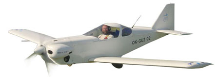

Deskpilot Posted August 8, 2011 Posted August 8, 2011 As you know, we are not allowed retractable under carriages unless we're flying an amphibious aircraft. So I'm allowed to purchase something like this and fly it legally. Almost a conventional aircraft with retracts, right? I'm not, however, allowed to by and fly this http://www.flyingmachines.cz/_english/b612/ ..........check it out, fit's our specs except for the retracts. Confused.

sain Posted August 8, 2011 Posted August 8, 2011 retracts are fine as long as you don't go over the weight limit. retracts are heavier than fixed gear and only provide a relatively small increase in airspeed. most aircraft designers don't bother to do retracts for aircraft within our allowed performance envelope. There are also complexity issues, and the need for a thicker wing (to stow the gear + wheels in), which offsets some of the benefit. I see no reason why you can't register an aircraft of that type under ra-aus rules. I'll point out that a hummelbird (fixed gear) will only be 10-20mph slower with far less complexity and 15 less ponies under the bonnet. and you could probably gain a little by putting wheel pants on the hummel.

frank marriott Posted August 8, 2011 Posted August 8, 2011 I would suggest below 150kts the gain from less drag V weight and cost [including maintenance] is not worth it. If your are landing on water then it is a different consideration............. Frank M
frank marriott Posted August 8, 2011 Posted August 8, 2011 how do u figure that Frank?......................how many of us are doing 150kts+?eg, 8kts extra at 100kts is a gain of 8%.....8kts extra at 150kts...well.. it aint! My point was only below 150kts I don't consider the cost is worth it - if an individual does well and good go for it - just not for me. Frank M
frank marriott Posted August 8, 2011 Posted August 8, 2011 you have a fast J230 Frank!!................... No I have a 120kt Jab , being from GA originally my comment was only that with our RAA [most at least] aircraft the gain from RU would be of little gain. I'm happy with fixed gear at 120kts. Frank M
deadstick Posted August 8, 2011 Posted August 8, 2011 Of course you can have retracts, an example is the pioneer range at Avalon they were 24 registered!
Deskpilot Posted August 9, 2011 Author Posted August 9, 2011 OooKayyy, I seem to have missed something. I was under the impression that what we flew had to be single engine, single prop, fixed gear(unless amphibian) and stall at less than 45knts. Guess I'm going to have another look at dem rules and make some sense of 'em. what section should I start in?
