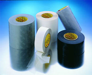

Guest harwis Posted August 30, 2011 Posted August 30, 2011 Thanks for all the reply. I search on Google, and I can get 3M 8673. It is a kind of Polyurethane tape, can be used on propeller, thinking about trying that. But william, if you know the name of that metal tape, please tell me. Harris

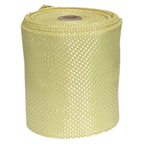

Camel Posted August 30, 2011 Posted August 30, 2011 I have used kevlar tape in the past on a trike and worked very well never got a mark on it, got it through a sailing shop years ago.
Guest harwis Posted August 31, 2011 Posted August 31, 2011 Here make a comparison between 3M and Kevlar. 1. 3M looks easier to put it on, Kevlar need adhesive 2. 3M have better looking 3. Which one is cheaper? 4. Which one is stronger?
Guest harwis Posted August 31, 2011 Posted August 31, 2011 3M™ Polyurethane Tape Polyurethane Protective Tape is made from a tough abrasion resistant polyurethane elastomer that resists punctures, tearing, abrasion and erosion. It is formulated for resistance to ultraviolet light. It can be installed in a minimum amount of time with simple tools. Constructed with a long-aging, solvent resistant, pressure sensitive acrylic adhesive that is protected with an easy release paper liner. Polyurethane tape is designed to be sacrificial, it protects to leading edge of your struts, or the leading edge of your propeller, over time it will be damaged by small stones, rain and hail and will need to be replaced.
Guest harwis Posted August 31, 2011 Posted August 31, 2011 Kevlar tape has many uses. Dr. Redden uses it for Equilox patches. It also works well to anchor aluminum shoes when derotating (aligning palmar angle) laminitic horses prior to performing deep flexor tenotomy surgery. Kevlar tape is much stronger and more durable than Multi-Use Fiberglass Tape.
Guest harwis Posted September 2, 2011 Posted September 2, 2011 The Kevlar Tape is $3 to $4 per meter, the 3M in (link removed - Mod) is $22 per meter. Seems Kevlar is much cheaper. But Kevlar is generally used for marine, right?
