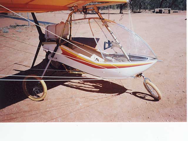

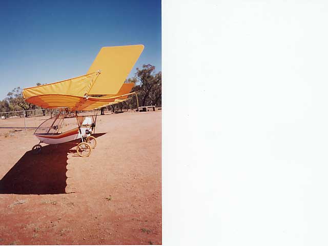

Golden Oldie Photos
Here are a couple of photos of my Kasperwing.
I built this from scratch in the early 80's from raw auluminium ,made a pattern for the sailcloth and cut the sail.Would not do it again! Had some help making the rudders by Grahame Johns.(Skyland Kites fame)
The pilot sits in a swing seat (no photo) and swings back & forwards for pitch control. The roll and yaw control is done by turning the "steering yoke" left and right. The rudders are activated by push pull cable and was very responsive. If you lifted the yoke then both rudders were activated causing a heap of drag in order to make a steep descent while still maintaining directional control.
This is what the original Kasperwing was supposed to do and create 'Vortex Lift' and create a very steep descent. In reality it was more hype than substance. After having flown the original Kasperwing I came to the conclusion that it was too unstable with only 1 degree of dihederal.
When I built my own version I increased the dihederal and wash out to 4 degrees based on experience from flying hang gliders. I used to fly an EF5 rigid wing hang glider and a mate had a Fledge 3 ET and so came to the conclusion based on their flying characteristcs.
It proved to be right as from the first time that it flew it handled really well and never had to make any adjustments from there on.
The second time I flew it I thermaled to 8,500ft; that was awsome and bloody cold. I had not fitted the fairing (cockpit) then. I did most of my flying out of Watts Bridge SEQ and bit in Mt Isa and Kooralbyn.
The first time I flew it was about a week after I got my GA licence. That was intersesting. In a C172 push the yoke forward, you go down; pull back, you go up! Push the pedal right, you go right; push left, you go left.
In my Kasperwing you push the yoke forward, you go up, pull the yoke back you go down. Push the pedal right, you go left; push the pedal left you go right. Very interesting. Keeps you thinking.
All part of the fun and the past.
