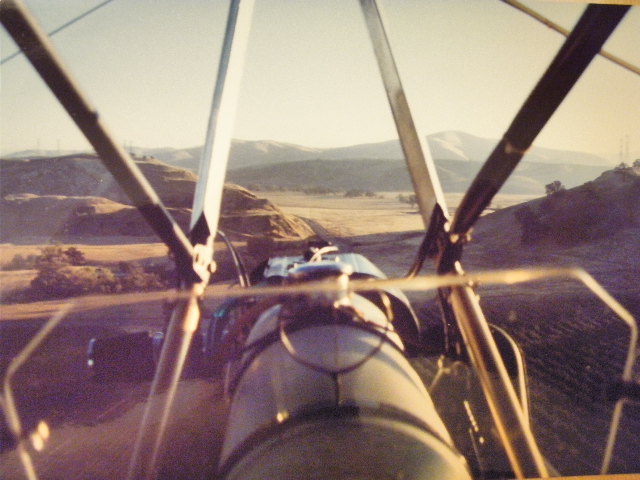

Guest Maj Millard Posted September 13, 2011 Posted September 13, 2011 Does sound like a fuel problem..however....I purchased a brand new 447 FC back in the late 80's for my homebuilt Bi-plane. Same as yours, single points ign, single carb, fan cooled. I had a faultless run out of it for 175 hrs, other than the CHT always wanted to creep up close to 375-400 F at full power. It always came back when throttle was reduced after takeoff. I'd have a look at what grade fuel Rotax recommends for that engine...I don't believe it is Premium UL...more like 92-95 octain only. 50 to 1 oil mix is correct. After an early morning take-off and about 10 mins into the flight mine spat a top (dykes) ring which put me into a field. I'd watched the temps come back that morning, and I'd always used quality oil. (Penzoil 2-stroke ashless in those days) The EGT is your most valuable guage on that engine, and the one to watch, as you will most certainly get a rise if things are not right with fuel/fuel supply. EGT tells you what the temp of the fuel burn is. Rich mixture should give somewhere between 900-1100 F. Ideal burn is around 1150-1250 F, and anything above that is too hot. A rich mixture will give the low temps, and a lean mixture the hot temps. EGT responds on the guage much quicker than CHT, so thats the one I'd be watching if it is a fuel supply problem.. If you have an internal problem with rings binding against the bore etc., then the CHT will rise accordingly... Also suspect a mismatch of oil and fuel, it's rare, but some 2-stroke oils didn't want to mix well with some fiuel types causing lack of adequet lubrication internally and improper combustion..............................................................................................Maj...
newairly Posted September 14, 2011 Author Posted September 14, 2011 Maj. That is in interesting bird! Is it based on any WW1 plane? Is it still around? The fuel I used for the recent ground test is premium unleaded (95 octane) with Pennzoil at 50:1 It was mixed just before use. Pennzoil still seems to be the best 2 stroke oil around for air cooled engines. The tests that I found 3 years ago rated it the lowest ash and best performing on a comparison test using a Rotax 503 (I think). Rotax say that 91 octane is OK but certainly no ethanol! Not too sure about the 91 octane. Incipient detonation can cause a sharp rise in temps so higher is safer, especially as octane number drops on storage with mixed fuel/oil. I may even go to 98 octane unleaded. The surging is quite slow. A period of 10-15 seconds. EGT at full throttle is 1150-1200. at part throttle, 5500RPM EGT is 1050-1150. My CHT also approaches 400F at full power. I am trying to get the Tyro going again after 2 years of not flying. One of the reasons I stopped flying it was because I was not happy about the engine, especially the part throttle problem. Phil

Guest Maj Millard Posted September 15, 2011 Posted September 15, 2011 newairly, Yes I still have the bipe in my shed. Did around 275 enjoyable hours in her (mostly air-combat against lesser machines !) Because your engine was stored you may have rust on the cylinder bores, the engine is fighting to break through it. The 400 egt needs to be watched closley...not good. remove a manifold and check for rust on the bore..........................Maj...
