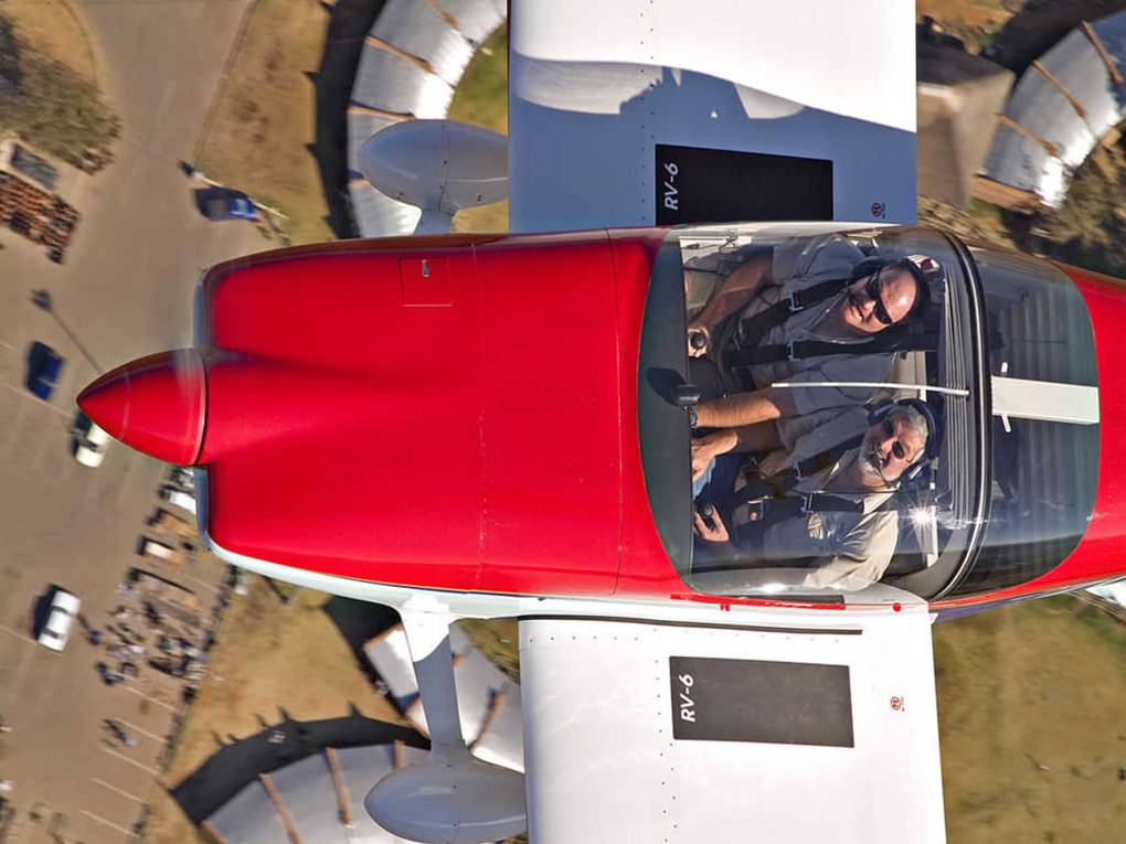

Pic #1 looks as if the photographer was hanging out the side of the plane. I wonder what was going through those two gents' minds ?

I think no.1 was taken in South Africa, bloke in RHS is John Miller, the photographer who caught the extremely low B707 pass in Harare that has featured here before. Photo taken from a doorless C182 for one of the aviation mags, I think it did quite well on A.net as well. The same team have a similar photo of the first RV12 completed over there as well, may have a copy somewhere in my photofiles.

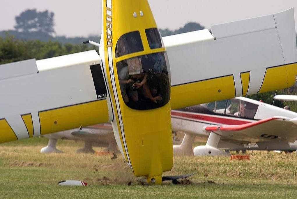

No.2 is quite a well known action shot; nose dragging RV suffered nose leg failure at a fly in, somewhere in the UK from memory. I saw somewhere that the aircraft had been repaired and was flying again.

I have seen #2 before...some comments were "tail dragger that hit the brakes too hard" and the "nose gear fail".
But for me the interesting items are the map on the canopy and the full flaps.
It does look like a wing stall, nose-in incident, considering that the first prop blade seperation has just occurred in the pic, where a nose over would have sheared all 3 blades to get to this pitch attitude.
Even at taxi RPM the prop would have had several bites at the ground before it gets vertical like this pic.
I don't know the outcome of this event and google-ing DRM (rego in pic) hasn't shed any light.
This photo, none the less, our reaction that would represent any of us in exactly the same situation.
I did a little more digging around, photo 1 was taken by John Miller and features ZU-RRV.

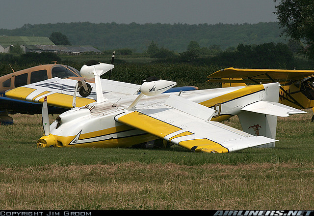

Photo 2 was taken in the UK in 2007 and apparently shows an RV-7A, G-CDRM turning over. I found a photo of the aftermath, according to the caption the aircraft was rolling out after touch down when the nose wheel dug into a soft spot on the runway, the leg failed and over she went.
Cheers Spin,
Must have been a quick roll, but glad it wasn't a stall-dive as it appeared. Seems like I wouldn't be a good accident investigator after all....lol
I hope no life injuries were an outcome of this event. The plane can be re-built..
Matt
It seems in this case the photog got it right, eye witnesses to these things are however notoriously unreliable because they tend to interpret what they have seen or half see. Here is a link to accident investigation report - I see they reckon the surface was dry n firm, undulations caused the nose gear to flex and the fork to dig in. Probably the source of much of what you hear about Van's supposedly delicate nose gear?
http://www.aaib.gov.uk/cms_resources.cfm?file=/Vans%20RV-7A,%20G-CDRM%2010-07.pdf

Here is a video, first showing the repaired RV7a, the crash and some stills of the incident. Vans Aircraft posted a statement saying that the owner contacted them with drawings etc of how he was going to install a larger wheel to the front leg. They advised him against this as it would put more stress on the front leg.

I have seen #2 before...some comments were "tail dragger that hit the brakes too hard" and the "nose gear fail"..
It seems like it is an RV7A that had a nosegear failure
