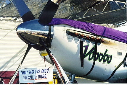

rgmwa Posted September 18, 2011 Posted September 18, 2011 If the tab was part detached it would be enough to cause the situation that occurred. You wouldn't need anything else wrong. Nev Result of a trim tab failure on another racing Mustang in 1998, but luckily without the tragic outcome of the Reno accident. http://www.warbird.com/voodoo.html rgmwa
Guest davidh10 Posted September 18, 2011 Posted September 18, 2011 Result of a trim tab failure on another racing Mustang in 1998, but luckily without the tragic outcome of the Reno accident.http://www.warbird.com/voodoo.html rgmwa Interesting. There's several points of photographic evidence that suggest the accident was a similar occurrence.
turboplanner Posted September 18, 2011 Posted September 18, 2011 Result of a trim tab failure on another racing Mustang in 1998, but luckily without the tragic outcome of the Reno accident.http://www.warbird.com/voodoo.html rgmwa In that crash, 10 g's is suggested, the aircraft pitched up, 10 g's is suggested and the pilot was unconscious, coming to when the aircraft had reached 9000' The impact of g forces could be the reason the pilot is not visible in this crash.
