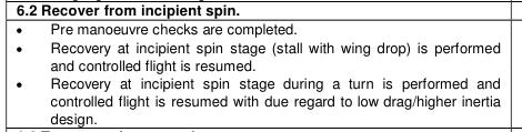

Powerin Posted September 27, 2011 Posted September 27, 2011 Quote Hi Foxy,is there any regulation in RAA that prevents instruction in stall / incipient spin as indeed I asked the question on a couple of posts back? FYI David - from the RAAus syllabus of Recreational flight training (High performance) :

motzartmerv Posted September 27, 2011 Posted September 27, 2011 Im sorry my comp is playing up and my replies are taking ages to appear. In the syllabus it says " stall with a wing drop" it says nothing about autorotation. The recovery from a wing drop is the same as a further developed spin. The question you asked regarding what is an incipient spin has been the subject of much hot debate at various cfi forums etc, and the genneral feelings are that the syllabus has the wording we need, ie, stall with a wing drop. I did stalling today and filmed it from inside the cockpit, i will post the video if your interested in what i am teaching. In a nutshell, the stall should be recoverd at the incipient stage, just the wing dropping, anything further would be likely to induce bank beyond 60 deg.s .and if you know that is going to happen then it is intentional. Cheers

motzartmerv Posted September 27, 2011 Posted September 27, 2011 C'mon david, 45 degs nose down is far beyond what an average stall would induce. Im with you, i reckon a quarter rotation etc is needed to see it properly, but unfortunatly the syllabus doesnt allow for it, it is simply a stall with a wing drop like it states. I didnt write it, but im bound by it. Cheers

motzartmerv Posted September 27, 2011 Posted September 27, 2011 Quote I understand your point Motz; it is just unfortunate that the syllabus uses the term 'incipient spin' which is not what RAA teach. The problem is the students believe that stall with a wing drop is an incipient spin ... so God help them if they ever cockup and enter a real spin, when low and slow turning final with the flame out trying to stretch the glide into some small paddock one day. David Couldn't agree more david. But, I would argue, a fully developed spin at 500 feet would be difficult to recover from regardless of training.;). I guess thats why the emphasis is on the wing dropping stage. I liken the current stance on stalling (and spinning) to pre Columbus sailing, where ya could sail anywhere in the world ya wanted to, provided you didn't go in water over your shoulders and never lost sight of land. Its not just RAA, but GA have backed off spinning as a requirement for issue of PPL and even CPL. They seem to have a "just say no to deep stalling" mentality. Im sure they have their reasons for this, but there has been 2 good reasons recently (RAA accidents) where I feel somewhere something should be done. cheers
