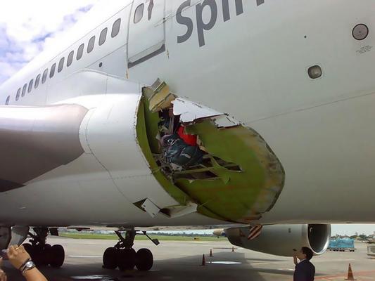

Guest Maj Millard Posted November 6, 2011 Posted November 6, 2011 thruster87, The photo in your post #36 showing the damage to the Qantas aircraft illistrates damage to a composit fairing does it not ?......These generally don't use rows of rivits in their construction.............Maj...

Thruster87 Posted November 7, 2011 Author Posted November 7, 2011 thruster87, The photo in your post #36 showing the damage to the Qantas aircraft illistrates damage to a composit fairing does it not ?......These generally don't use rows of rivits in their construction.............Maj... Maybe if you look a little deeper. Cheers [used to take these fairings of to do inspections, when I worked for Qantas]
