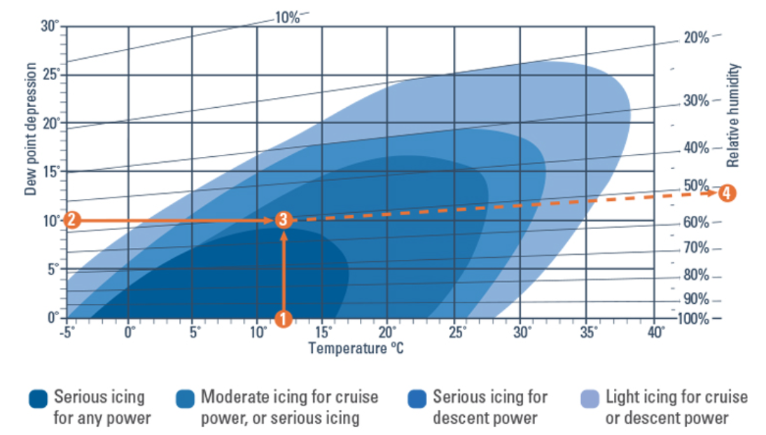

RFguy Posted December 17, 2022 Posted December 17, 2022 somewhere around there is a nice FAA chart of likelihood of icing versus temperature and humidity it is worth a look . here is a study on it http://www.tc.faa.gov/its/worldpac/techrpt/ct82110.pdf 2 1 1

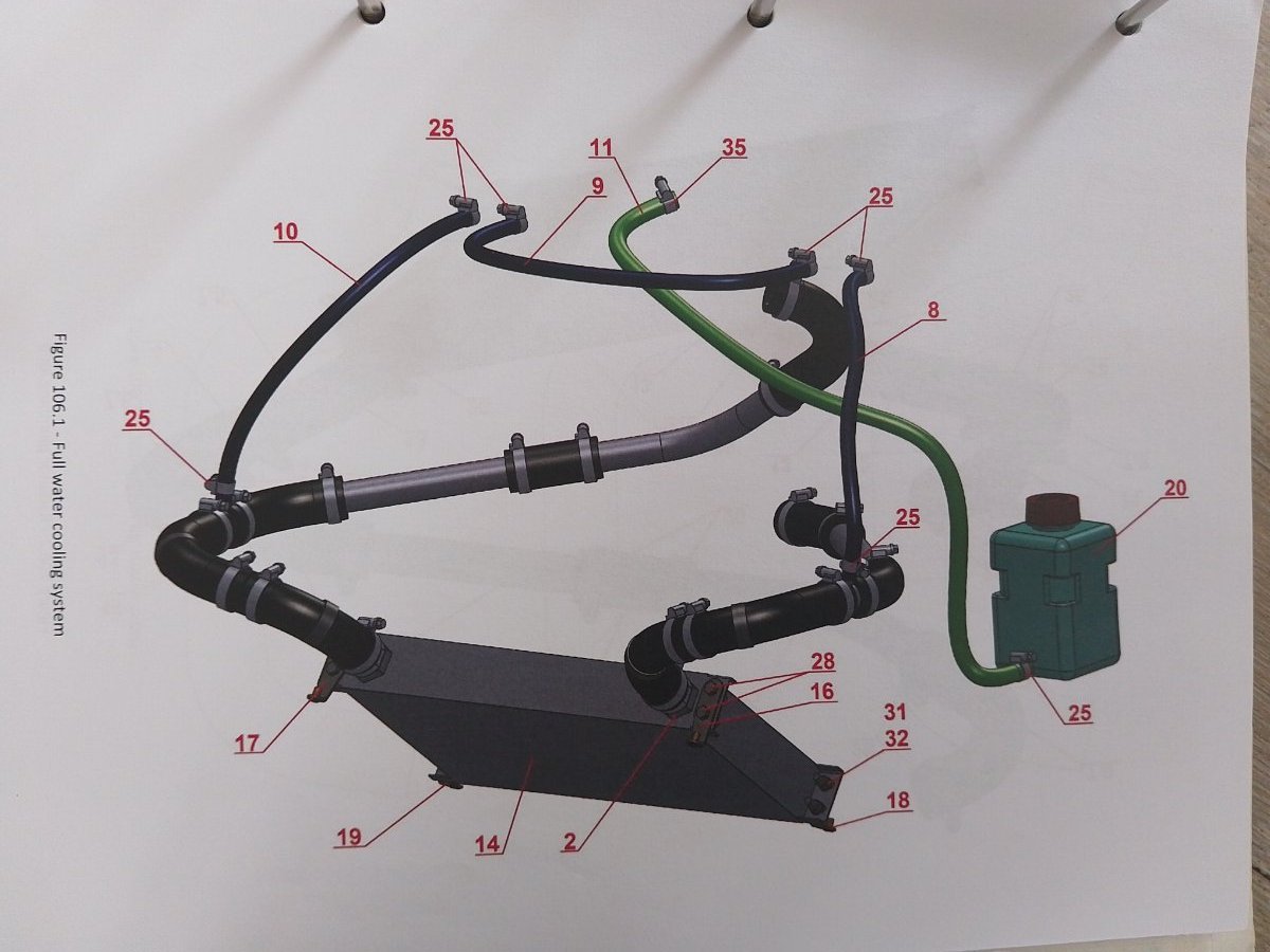

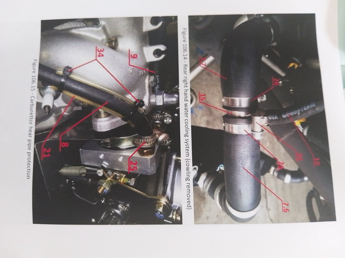

danny_galaga Posted December 17, 2022 Posted December 17, 2022 I misspoke I realised afterwards. The Rotax carb heat I have actually only warms the inlet (water jacket). It's on all the time so I was imagining you would lose power. But since it is only really warming the inlet, and not the air there is virtually no power difference. I guess I'm trying to avoid all the extra plumbing and weight. 1
