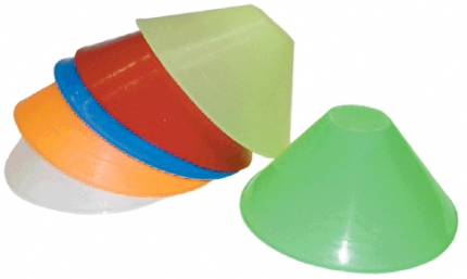

numptie Posted May 28, 2007 Posted May 28, 2007 You could use these marker cones we used to use for touch football. The one's in the picture are only 4 inches but I'm sure you could get larger ones. They're available in bright colours and they are soft so they won't damage aircraft if you run over them. You could hold them into the ground with small tent pegs. And the best thing is they're cheap and available from any good sports store. Bob

Matt Posted June 13, 2007 Posted June 13, 2007 Have you looked at www.fgmcoffs.com.au? Just saw an ad in the Flight Safety Magazine and noticed they were the same cones we saw at Point Cook last week. They looked good and I believe they are quite reasonably priced. Cheers, Kaz
