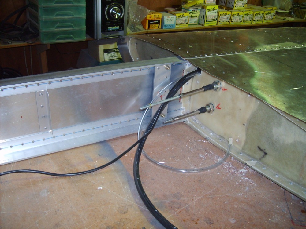

Would anyone have some photos of the aileron control system in the wing of a Morgan design?

Its pretty simple, just a cable in the wing with pushrods on either end to the aileron horn and to the control column (quick release on mine for easy wing removal from the control column).183535325_Aileroncable2.thumb.jpg.d8b30e7eef63c55bd8122d412deb9968.jpg
There is a very fancy code for each cable. A = Aileron & F = Flap. The wing is upside down on the bench.

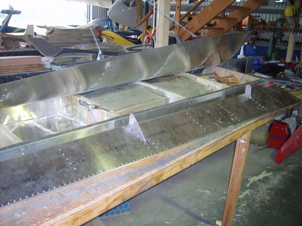

This is not the wing of my Sierra but that of Kevin Harrison's one when it was built at Taree. I just happened to be there when the wing walks were being done so the bottom skin was nicely peeled back for a photo of the innards. The wing tanks are 35-40 litres a side as I recall with a 100 litre fuselage tank. Kevin or Alan Marriette may wish to elaborate. I haven't got to the wings of mine yet. I spent about 6 weeks ripping the new house to bits to fit in a new bigger Kitchen as per my wife's specifications but am back into the build as of tomorrow as I have just got my garage back.
