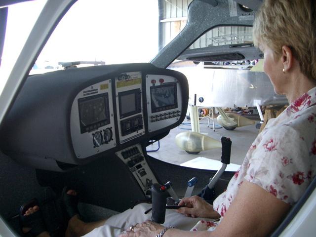

Now came the hard part...as Leo (from Sports Aircraft Australia) was not arriving to supervise the re-assembly until late the following Tuesday night, the days went by very slowly, however on Wednesday 17th May things began to happen very quickly and by Friday 19th the aircraft had been reassembled, gone over very carefully by the CASA LSA team and by 1500 we were doing our first test flight, having been issued with our LSA CofA and registration.

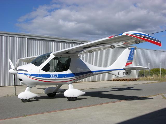

We are absolutely delighted with the aircraft. As many of you would have noted from the pictures, we went for the large tyres and heavy duty undercarriage. Flight Design have improved the wheel fairings on the larger wheels, making them look much more in proportion than on previous models.
I was expecting some drop off in performance due to the larger wheels however at 5000 ft at 565 kg (just 35 kg below MTOW) and with full course pitch on the Neuform 3 blader at 5000 rpm we were getting a TAS of 122 kts. I had a Dynon fuel flow sensor fitted by the factory and it was showing about 20 Lph on the EMS.....this may improve as the Rotax loosens up a bit.

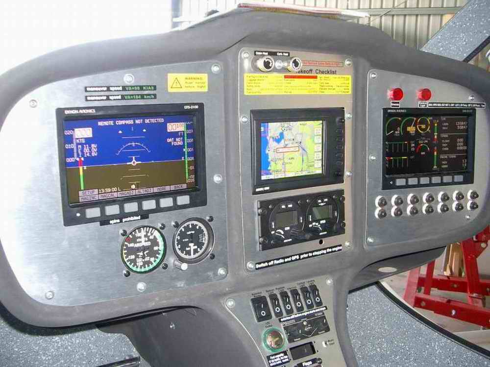

The Dynon EFIS & EMS is a delight. An external digital compass comes standard with the D100 however I added an OAT probe, thus giving a OAT/TAS & Density Alt readout on the PFD. I also have the Dynon AOA pitot which brings up an angle of attack indicator on the lower left of the PFD underneath the ASI tape. (pic will follow when I figure out how to post!)

Basic empty weight as per the factory W&B chart is 319.1 kg (extra weight mostly due to the bigger wheels and heavy duty landing gear). i.e. Tundra wheels & fairings = 6.5 kg Heavy duty landing gear = 3.5 kg.
The Neuform 3 blade variable pitch prop. weighs 5 kg.

Here is a pic of the panel prior to the wings being attached....as you willsee on the EFIS there is an " EDC not detected" as well as " OAT not found"message as the remote digital compass and OAT probe are located in the left wing, so was at this point not connected.
AOA scale is on the lower left below the speed tape.
