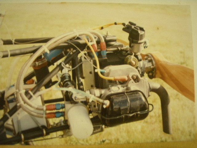

Guest Maj Millard Posted January 28, 2012 Posted January 28, 2012 Spacesailor, I flew with a two-pot 1/2 VW back in the 80s. Don't know what the horsepower was, but it got me off the ground. When I needed a prop for it I called a local Californian legend Craig Catto, as he was making nice wood props back then. I described what I needed, and he asked me a few questions about the aircraft, that's all. The prop arrived about a week later, and it was within a degree of being perfect !!. I believe I still have it somewhere in a place of honour. I sourced my crank, heads and prop flange from Morry Hummel, and enjoyed many pleasant conversations with him on the phone.................................Maj...
spacesailor Posted January 28, 2012 Posted January 28, 2012 Hi Maj, Is the biplane the 1/2 vw powered ?. Can you remember the prop dia., The 1/2 vw can use 46" to 52" & still climb away. My aircraft is a "HummelBird" plus another fuse,. to use when I'm use to flying it as a trigear I will change to the tail dragger. IF ever I can pass the BAK tests, Made a couple of 48"X36" props to run_in the engine. straight prop was noisy the curved prop ran slower revs, next I want to try a "Scimitar" for the open air bryan:plane:

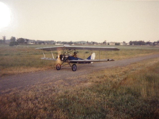

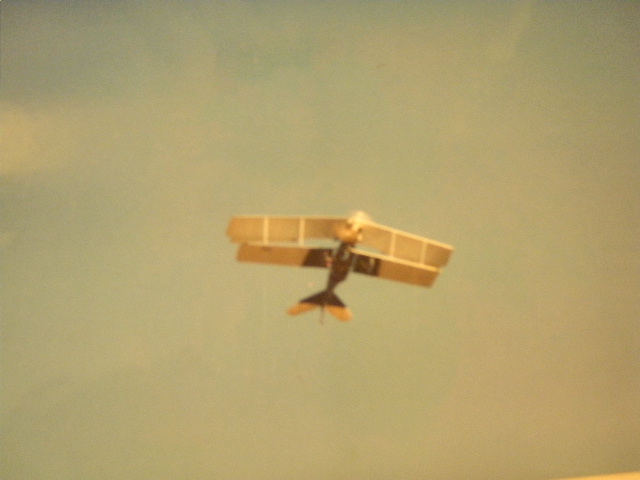

Guest Maj Millard Posted February 29, 2012 Posted February 29, 2012 Spacesailor, the props I used on the 1/2 vw were either 54 or 56 " with a round a 24-26 degree of pitch. Blades were reasonably wide at around 4.5 " at widest point. Pete bess....during the 80s there were a few UL WW1 replicas around, so I designed and built my own. It is a rough copy of an Albatros C1 which was a two seat german 'hack' used for observation, training and general use. Richtofen used one on his off days to travel to Berlin for R&R. It's unusual in that it is one of only a few Bipes to have both wings swept at 10 deg. The Tiger Moth is one other. Not even a Pitts has both swept to 10 deg. The main wing on mine was built utilizing many parts from the Easy Riser, designed by Larry Mauro, whom I knew personally in California. It flew very well and I flew it for several years. It sits in my shed now waiting for another war...............................................Maj...
Yenn Posted February 29, 2012 Posted February 29, 2012 I can understand one wing beeing swept, but why both of them?
Guest Maj Millard Posted February 29, 2012 Posted February 29, 2012 Well yenn my friend my best answer is "you'd really have to have flown one"...The early Geman machines tried everything, and they seem to like the double swept wings....german technology ??...I don't know. From an engineering point of view it's not easy, as you also need some dihedral on the botom wing....double angle into the fuselage. The 'ultimate wings' that are fitted to a standard Pitts are double sweep and they seem to certainly improve on Pitts performance in the right hands, and that's saying something !!. When I was designing and building my bipe I had this serious concern that in a turn it would just want to keep going. Really with the sweep there was nothing to stop it. Lower wings just increase in sweep and loose lift and top wings decrease in sweep and increase lift....what's to stop them tucking into a turn ?...... First flight was a dream, it had no such tendencies at all, in fact it loved to turn and the turns could be made super tight. Literally it would turn on a wingtip...maybe the Germans knew what they were doing after all !!..............................................................Maj...
