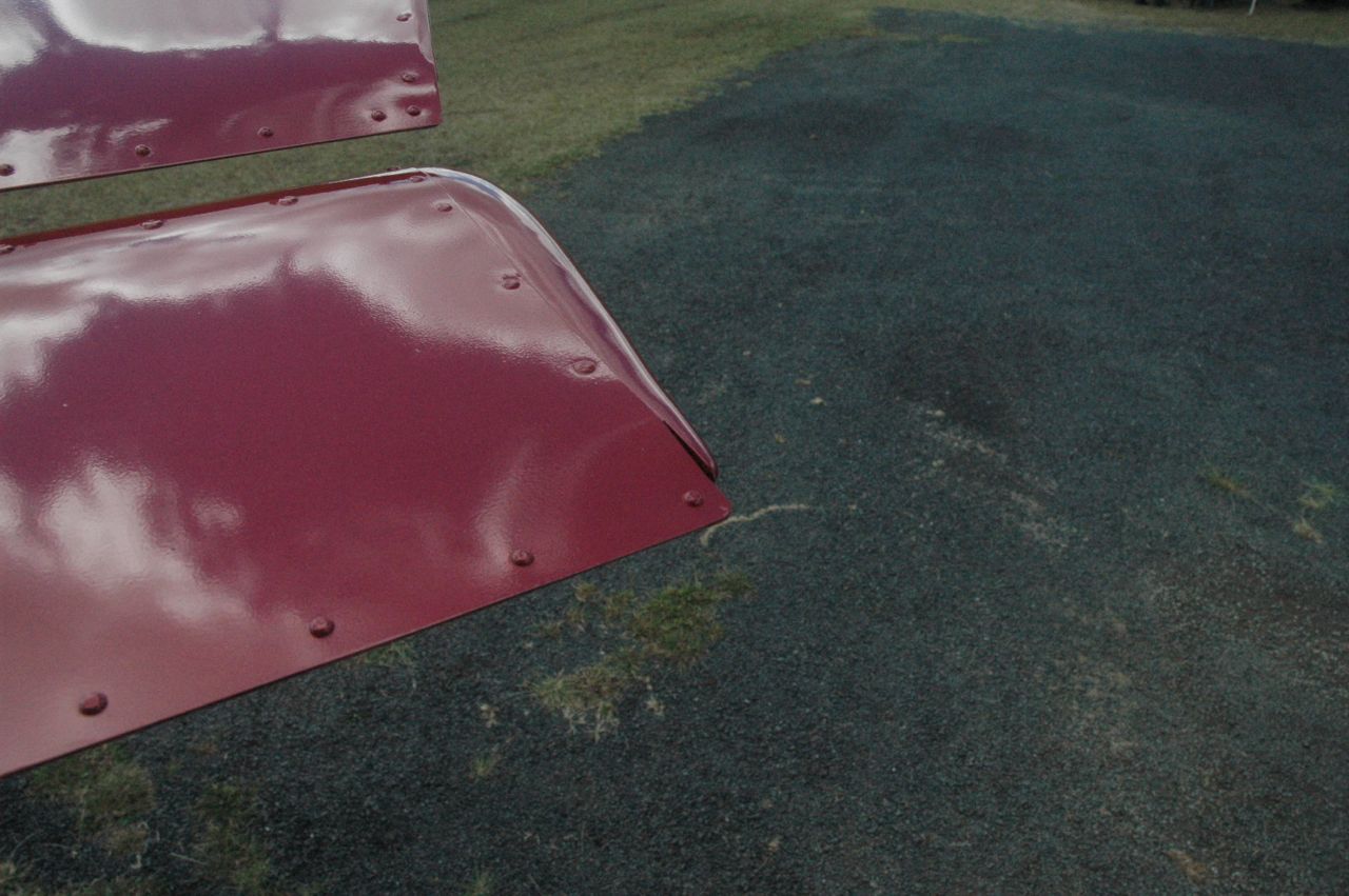

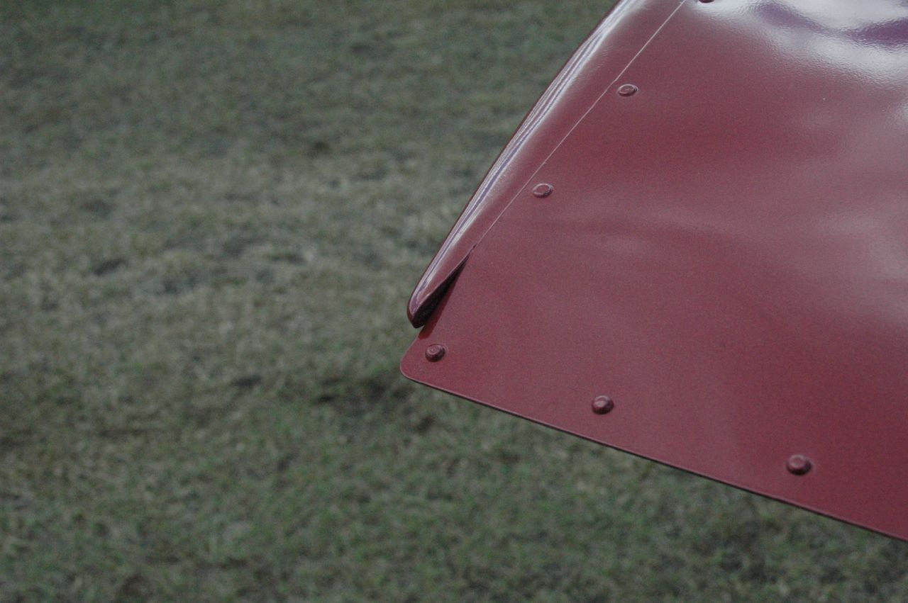

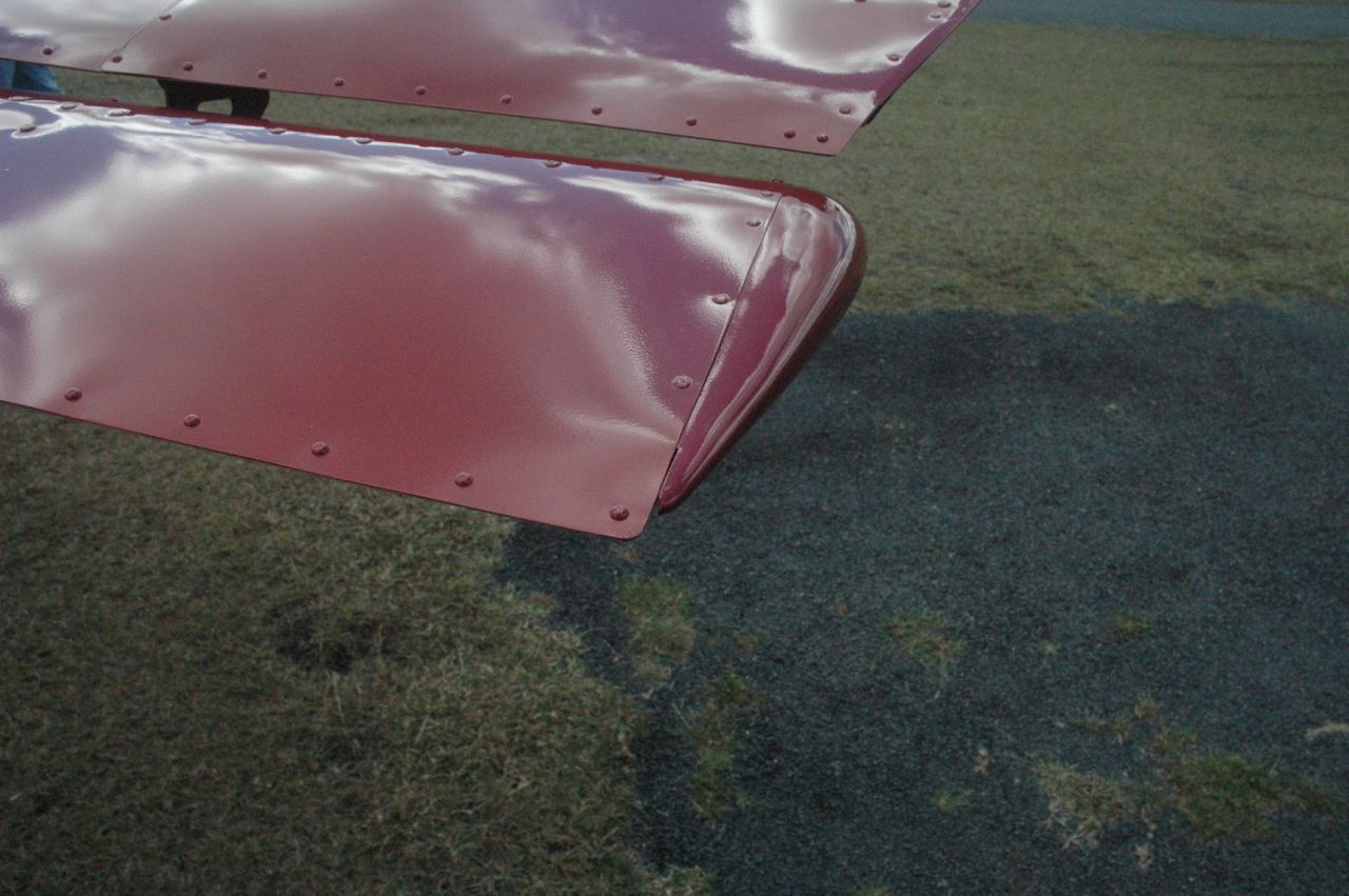

bobcharl Posted December 21, 2011 Author Posted December 21, 2011 Got the flaperons completed. Well, almost. Ican't work out the best way to fit the plastic tips on the ends of the outer sections. They fit the leading edge nicely but the trailing edge doesn't want to look decent at all. I might have to set them aside and see what has been done on other Savs. I put a strengthening doubler inside the ribs where the tabs between the inner and outer sections rivet on just as a precaution even though problems in that area seem rare. I have a feeling any stress on these tabs could be caused by misalignment of the hinge points on the wing and fuselage. I will see how they line up when I get that far. Now for the fuselage. I note this website now has a "Builders Blog" section. I wonder if thats where I should be posting this drivel. What does everyon think? Bob
Kyle Communications Posted December 22, 2011 Posted December 22, 2011 Hi Bob Just keep using this thread you started...that way all the savannah's are in the one forum. I haven't done my tips for the flaperons yet as I haven't bought all of those over from where they are stored with the wings until I have the fuselage ready to "lockup stage". Did I send you the photos I took of how Reg brost does the flaperon tips? Mark
bobcharl Posted December 22, 2011 Author Posted December 22, 2011 G'Day Mark, Great to see you project continues to romp ahead. I love your paint job. No, you haven't sent me any photos of aileron tips-I would certainly appreciate any that you have which might give me some ideas. Bob
Powerin Posted December 22, 2011 Posted December 22, 2011 Keep up with the drivel Bob . The thread has over 600 views so there's plenty of us reading it. On the subject of photo resizing: I use Google Picasa to manage my photos. If you use the "Export" button you can choose to resize the photos. So I go through and select all the photos I want to post, resize them and put them in a separate folder all in one hit. Microsoft also had an image resizer for WindowsXP that worked from within Explorer. You right click on a photo and you can choose to resize it straight from the menu without having to go to a separate program. If you still run XP you can still download it from Microsoft here. There is one (not from Microsoft) for Vista/7 users that works the same way...get it from here.
Kyle Communications Posted December 22, 2011 Posted December 22, 2011 Hi Bob I think he cuts the rear edge to get them to fit. I hope to start my engine in the next day or two...just getting the fuel system finalised so I can make it like as if I have the tanks inline....just been crazy busy here with work...its that time of the year here people leave everything till the last minute If you have a mac its really easy to resize :) its built in Mark
