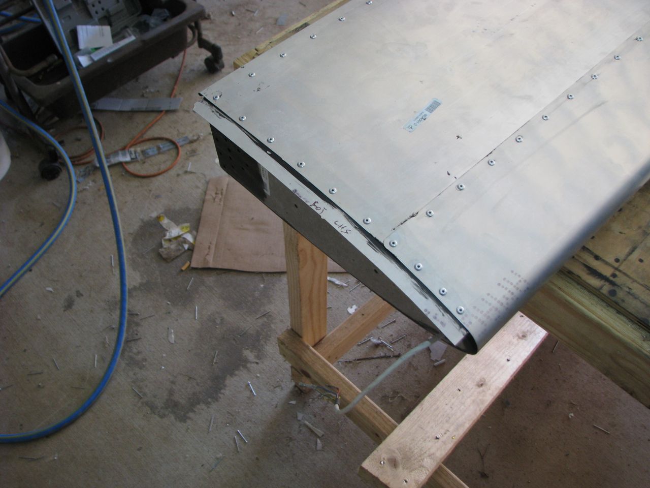

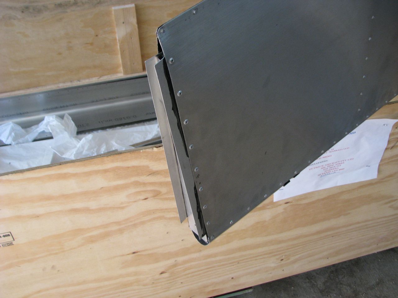

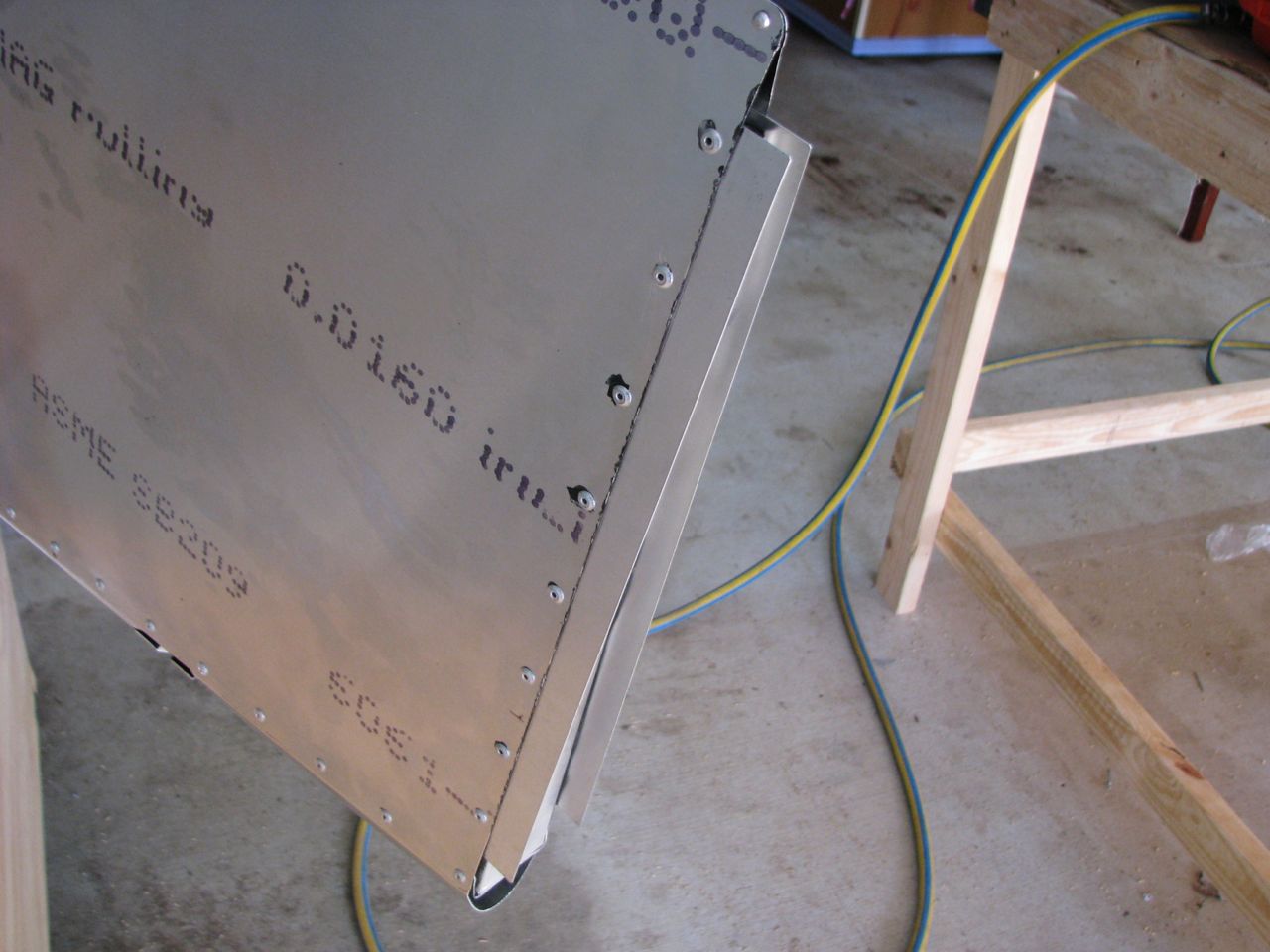

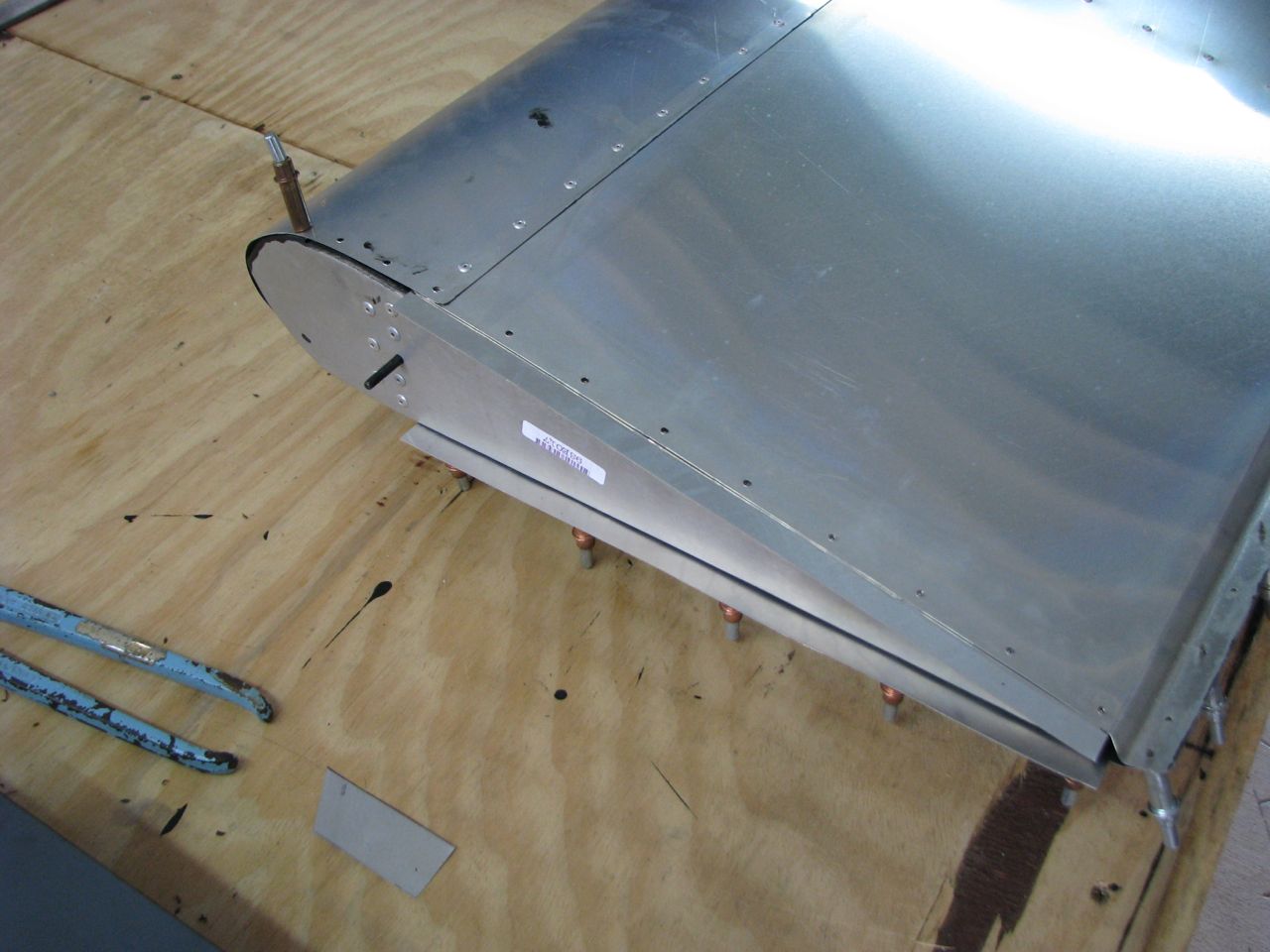

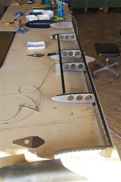

Kyle Communications Posted December 24, 2011 Posted December 24, 2011 Bob I am thinking of doing the tips for my flaperons the same as I did the tip attachments for the stab,elev,fin and rudder by slipping a 25mm strip of .5mm alu in between the outer skin and the end ribs like below pics
rankamateur Posted December 24, 2011 Posted December 24, 2011 I built those maroon flaperons and eight others (for two other planes) over an eight day period, and the over riding priority was to build them well but not introduce any more weight than necessary. What ever way you choose to mount the end cap you will always have the trailing edge of the cap about five times as thick as the two 16 thou aluminium sheets solid riveted at the trailing edge. If you do them the same as the maroon ones, get a thin disc in your angle grinder and cut away 15 - 20mm of the portion of the cap's trailing edge which will be within the aluminium of the flaperon, which prevents the aluminium being distorted where the trailing edges come together. Also, DO NOT seal the opening, they must be able to drain water so it doesn't freeze at altitude. ADDED Look at Mark's post, he has a photo of an end cap prepared this way.
bobcharl Posted December 24, 2011 Author Posted December 24, 2011 Hi Guys, Thanks for the ideas re flaperon tips. Will take both ideas to the workshop with me after Xmas.I'll keep you updated. I think I have the resizing of photos sorted.(I'm a slow learner). Watch for the next post. Have a Merry Christmas. Bob

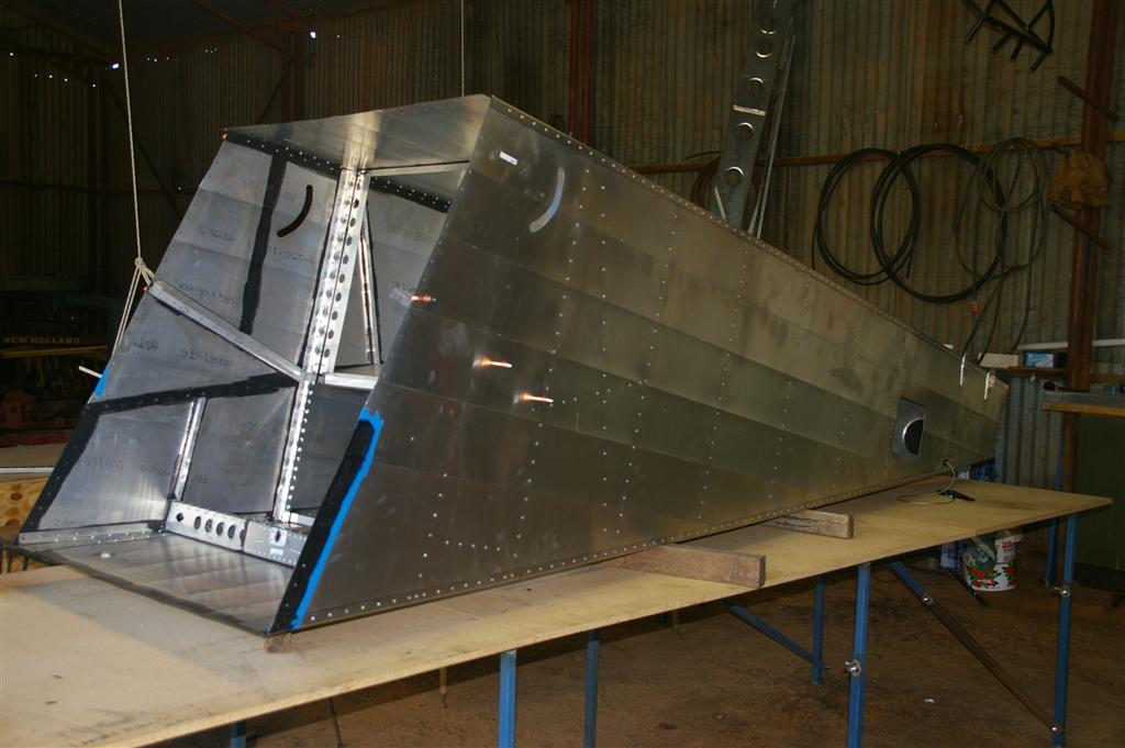

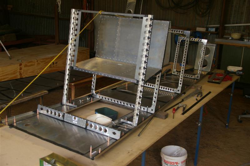

bobcharl Posted January 24, 2012 Author Posted January 24, 2012 Christmas and its associated socializing has not been conducive to Savannah building but Iwouldn't miss it for quids. Assembled the fuselage ribs and that was easy.A word of caution though: the rudder cables which must be installed at this stage are left and right specific. Mine were not tagged and I assumed them to be identical. Not the case. The parts manual does give them separate numbers, but I didn't pick up on that until later.According to the manual the two slender ribs should be riveted to the skins and the corner braces added after assembly. I couldn't see how that could be done without the services of a pygmy, which I didn't have, so I riveted them together and installed them the same as the other ribs and the skins went over them fine. Clecoing the corner longerons required quite a deal of levering with the probe to bring all the holes into alignment. Some at the front did require a hone with a drill where several layers were involved. I was advised to install the extended baggage compartment before skinning and I think it proved to be good advice.Thanks to some earlier advice on resizing photos there should be some photos with this post. The one of the stabilizer skeleton shows the gap in the front where I later added a support that I mentioned in an earlier post. The rest are self explanetory. Bob
bobcharl Posted January 24, 2012 Author Posted January 24, 2012 Sorry guys about the out of sequence problem in the photos in the previous post, but I'm sure you will sort it out, even if I can't. Bob
Kyle Communications Posted January 24, 2012 Posted January 24, 2012 Hi Bob Not sure if you saw my last post in my thread but I looked at the flaperon tips and cutting them produces a nice fit you can see it in the pics Mark
bobcharl Posted January 25, 2012 Author Posted January 25, 2012 Mark, I did see the pics on your thread and I think that is probably the best option. I will most likely go the same way unless a better idea comes up. Bob

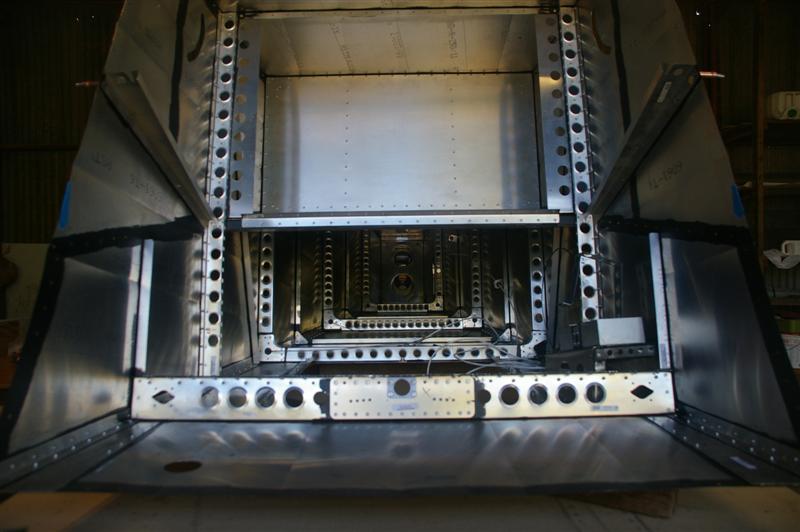

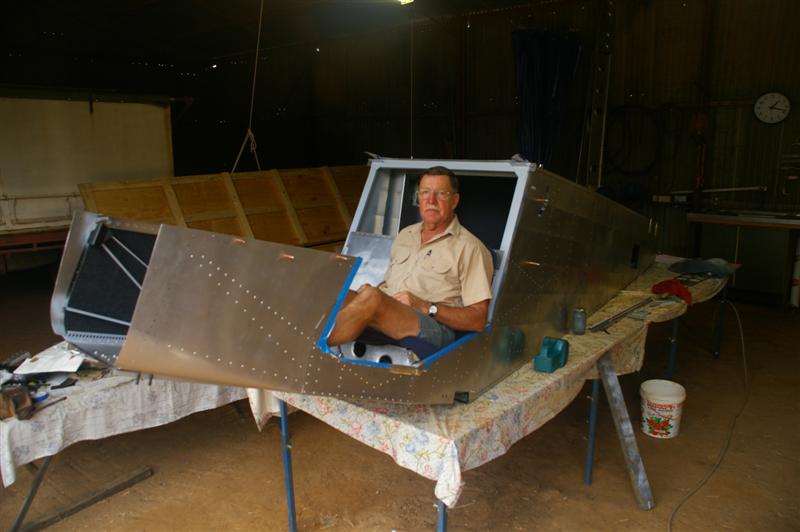

bobcharl Posted February 26, 2012 Author Posted February 26, 2012 Just a brief update. The cabin floor and forward fuselage are now assembled. Mostly went quite well: only doubt I have is that the cross member at the front of the seat is under some tension due to the fuselage sides having to be pulled in quite strongly. Some upholstery is in but many pieces have to be cut to fit. The flaperon control lever which is a bit topical at the moment fitted well and I just HAD to sit in the seat to try it out. (I haven't flown a Savannah from the LH seat).In view of some reports of the lever slipping out of the notches I cut the notches a little deeper and it now looks as though it could never slip out. I am wondering whether to stretch the spring slightly also. Haven't made a huge amount of progress lately due to lots of non-aviation happenings, but I have tomorrow off work and it looks as though it will be raining so I should be able to get into the shed and work without any distractions. Cheers, Bob
pudestcon Posted February 26, 2012 Posted February 26, 2012 Quote Just a brief update. The cabin floor and forward fuselage are now assembled. Mostly went quite well: only doubt I have is that the cross member at the front of the seat is under some tension due to the fuselage sides having to be pulled in quite strongly. Some upholstery is in but many pieces have to be cut to fit. The flaperon control lever which is a bit topical at the moment fitted well and I just HAD to sit in the seat to try it out. (I haven't flown a Savannah from the LH seat).In view of some reports of the lever slipping out of the notches I cut the notches a little deeper and it now looks as though it could never slip out. I am wondering whether to stretch the spring slightly also. Haven't made a huge amount of progress lately due to lots of non-aviation happenings, but I have tomorrow off work and it looks as though it will be raining so I should be able to get into the shed and work without any distractions.Cheers, Bob [ATTACH]16662[/ATTACH][ATTACH]16663[/ATTACH] Well I must say you look very much at home sitting there Bob:smile: Pud
Kyle Communications Posted February 27, 2012 Posted February 27, 2012 Looks good Bob Its even better when the sticks and peddles go in then you can make the broom broom noises too :)
eightyknots Posted February 28, 2012 Posted February 28, 2012 Quote Just a brief update. The cabin floor and forward fuselage are now assembled. Mostly went quite well: only doubt I have is that the cross member at the front of the seat is under some tension due to the fuselage sides having to be pulled in quite strongly. Some upholstery is in but many pieces have to be cut to fit. The flaperon control lever which is a bit topical at the moment fitted well and I just HAD to sit in the seat to try it out. (I haven't flown a Savannah from the LH seat).In view of some reports of the lever slipping out of the notches I cut the notches a little deeper and it now looks as though it could never slip out. I am wondering whether to stretch the spring slightly also. Haven't made a huge amount of progress lately due to lots of non-aviation happenings, but I have tomorrow off work and it looks as though it will be raining so I should be able to get into the shed and work without any distractions.Cheers, Bob [ATTACH]16662[/ATTACH][ATTACH]16663[/ATTACH] It appears to be climbing at about 1,100 ft/min at that angle: just add wings

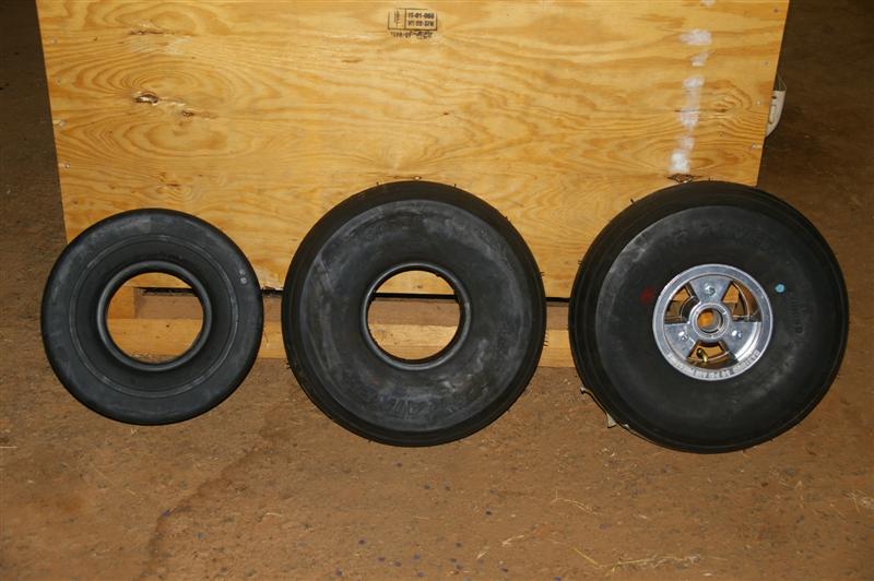

bobcharl Posted May 29, 2012 Author Posted May 29, 2012 G'day All, No, I haven't fallen off the planet, just haven't had time to indulge in matters aeronautical lately. The reason? My son has a grain growing property in Southern NSW and this time of year sowing is in full swing so for the last few weeks he has had my arse anchored to a tractor seat. Did snatch a few minutes ( and that is all it took) to unpack my Aero Trainer tyres and fit one to a rim. Like the look of these tyres, should be good on my planned farm airstrip. Should be back Sav building soon. Now to see if I can upload a pic of the tyres. Bob Hey, it worked!
eightyknots Posted May 30, 2012 Posted May 30, 2012 It's pretty clear that you'll get quite a bit of extra ground clearance with those tyres ...on the standard rims no doubt. How much extra weight is there per tyre, compared to the standard one?
bobcharl Posted June 3, 2012 Author Posted June 3, 2012 Hi 80K, Yes, still using standard rims and these tyres slip on easily. Weight? An extra 800gms per tyre over the standards. Thats 3.5L of petrol that I can't carry, or perhaps 2.5 kg of fat that I will have to lose. Whilst on tyres , the originals are still in the box and are for sale if anyone is interested. I won't be driving too hard a deal. Bob
eightyknots Posted June 4, 2012 Posted June 4, 2012 Quote Hi 80K,Yes, still using standard rims and these tyres slip on easily. Weight? An extra 800gms per tyre over the standards. Just looking at the picture, it seems you've gained at least 100mm in ground clearance, possibly more. That would make life a little easier on the prop in grassy terrain, I suppose. Also, that extra rubber must make landing a bit more comfortable! Quote .Weight? An extra 800gms per tyre over the standards. Thats 3.5L of petrol that I can't carry, or perhaps 2.5 kg of fat that I will have to lose.

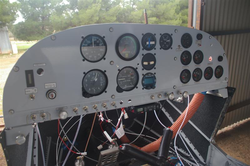

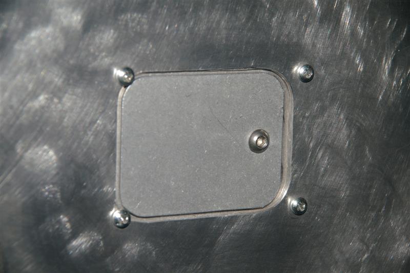

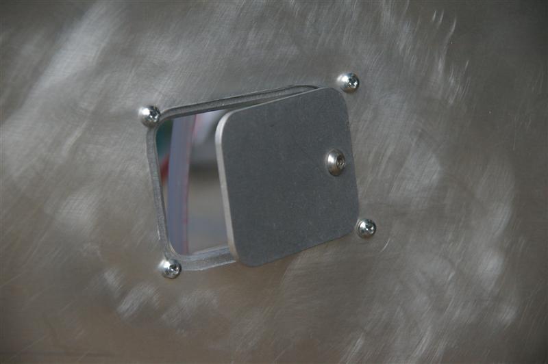

bobcharl Posted June 24, 2012 Author Posted June 24, 2012 Have managed to get some time back at my project at last. Decided to put some airvents in the forward fuselage adjacent to the pedals.Took lots of time but should be good in the warmer weather as these vents do work well. To the Jab jockeys out there, if you think they look familiar then you are right.Have also assembled and installed the instrument panel but it is nothing at all unusual. Am now running wires, airlines and hydraulic tubes and this also is quite time consuming. Slowly slowly but ever forward. Bob [ATTACH]17974[/ATTACH][ATTACH]17975[/ATTACH][ATTACH]17976[/ATTACH] 1
bobcharl Posted June 24, 2012 Author Posted June 24, 2012 Can't master posting pics.See if this works for above post. Bob
