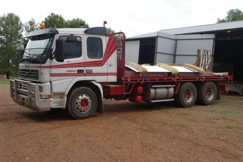

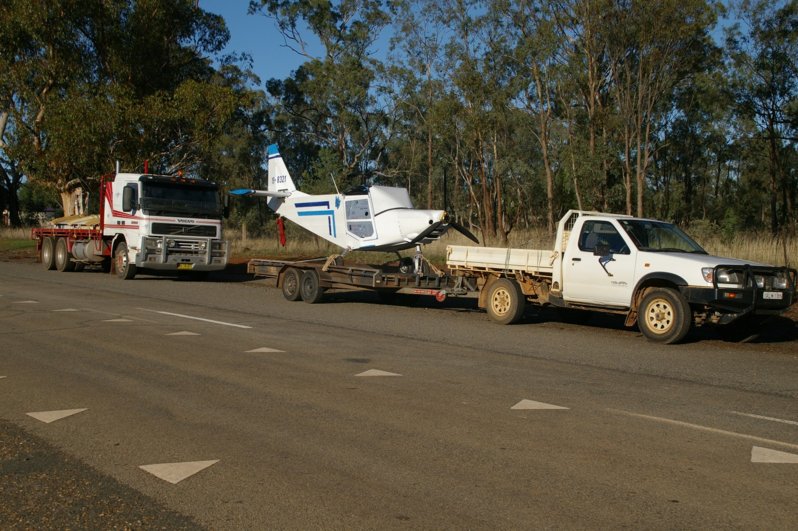

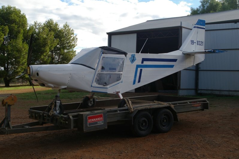

bobcharl Posted April 10, 2014 Author Share Posted April 10, 2014 Hi All, Another update. Windscreen went on fine. Suppose it should when it is an exact replica of the first one Time has arrived to transfer my project to an aerodrome for final assembly and test flying (after the registration process that is)'Temora is the new (temporary)home. The shift went very well with a tandem trailer for the fuselage and a flat bed truck for the wings. All transported well and unloaded without a scratch. Wings and flaperons all installed and is starting to look like an aeroplane, all this as per the pics. Don,t know why this program loads the pics out of sequence sometimes. Now have the fairings from the wing to the windscreen to fit and a few smaller jobs to do and I will be getting close to that final inspection. Cheers Bob 1 Link to comment Share on other sites More sharing options...

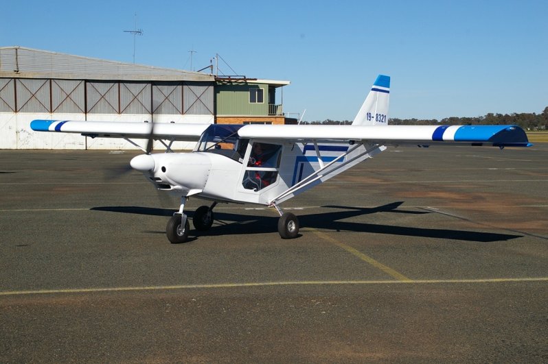

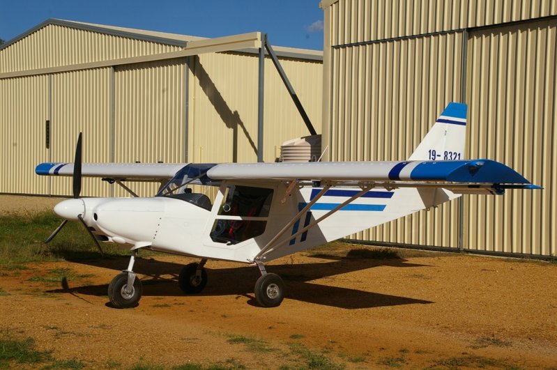

bobcharl Posted April 17, 2014 Author Share Posted April 17, 2014 Well, Savannah completed and final inspection done. All passed except for a loose bolt and an altimeter needing recalibration. Both rectified, registration application posted, and I wait, not so patiently, I'm afraid. It will be on display at Natfly this weekend. Will now try to upload a pic of the beast. Cheers, 1 Link to comment Share on other sites More sharing options...

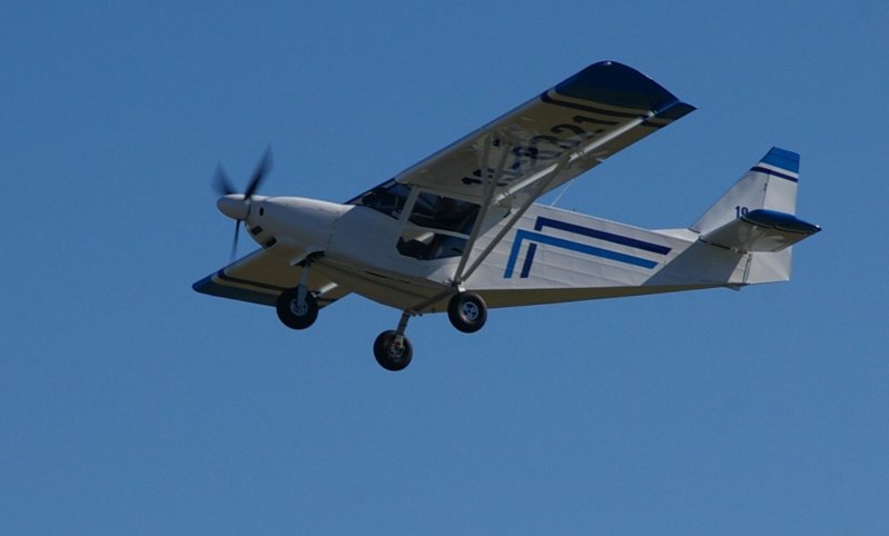

bobcharl Posted August 6, 2014 Author Share Posted August 6, 2014 IT FLIES!! IT FLIES!! Yes it really does. Put the test pilot on board and turned him loose yesterday morning and he spent almost an hour putting it through it's paces. In the arvo it was my turn and that was just a wonderful experience. Worth all the waiting. Most striking feature is the short ground run on takeoff. Of course we found a few things which need some adjustment. 1) Oil temp only rose to 70 deg. so I have blanked off a portion of the oil cooler and tried it today but still only 90 deg. so still more to be done there. 2) Elevator trim tab needed the linkage adjusting to provide a bit more nose up trim. It really requires the full range of the servo to give the necessary nose-up and nose-down trim. 3) In hands off mode it has a tendency to drop the left wing. Its very slight but its always that wing. While flying you are hardly conscious of applying any right stick. Don't know if it is worth doing anything with at this stage. Any feedback on these issues welcome. Despite the above, which is no more than expected , I am getting an absolute buzz out of flying it. I just can't wait to get the 25 hours done and then to go somewhere. Regards, Bob 3 1 Link to comment Share on other sites More sharing options...
