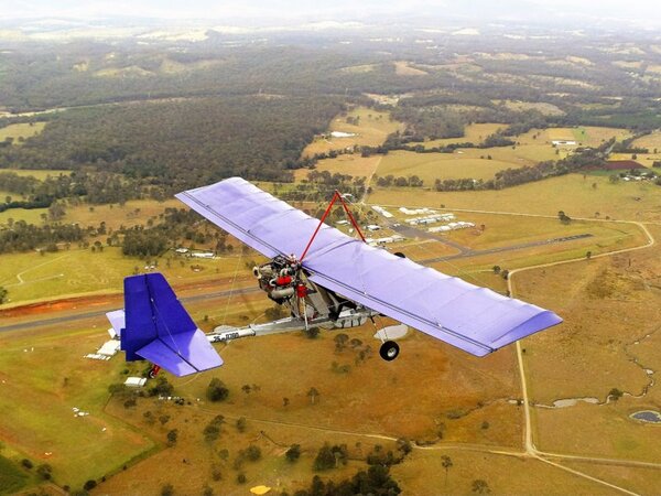

I can answer one part for you 912 can be retro fitted to a wire braced Ausflight done it. Retro fitting the Strut braced seems to be a no go due to the take off weight. However unless you have alot of cash, time and love doing paper work I would forget itFILE4090.JPG.a4de2021b1d9d99c7c7836c7f2509c5f.JPG
So let me get this right........
You have a factory built aircraft (25 reg)?
You changed a motor for a higher powered one.
It is still registered as a factory built.
Did you go through the MARAP process for this modification?
So let me get this right........You have a factory built aircraft (25 reg)?You changed a motor for a higher powered one.
The answer to the question is yes. We where one of the first to use the MARAP process, we have kept the 25 reg and its advantages it was a very long and expensive process, but once we started we had to see it through.
