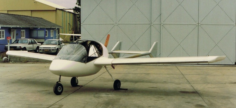

The single seat Vampires built in Australia, were quite different to the original American versions.
Ours had shorter wings, more power, thicker materials, suspension all round, a structural Kevlar/glass pod and probably some things I can't think of right now.
As for flying qualities, I found them easy enough to fly, if a little under powered with the Rotax 447 driving the flat bladed Ultra-Prop.
Some later machines ended up 503's and Brolga blades in the Ultra-Prop hub, these went really well.
Although they were fairly short coupled, they did have a big elevator, and a semi-symmetrical section with a low pitching moment.
Full flap was best used with a bit of power, but as for thrust powering the elevator, our demo/test pilot would regularly finish the routine with a dead stick landing and roll up the taxiway with the canopy open.
Aircraft always made an attention getting bang when shut down in flight from over run fuel in the muffler (no idle cut-off).
The company also sponsored a 'club' demo aircraft that could be flown if you were a member and checked out by the company demo pilot.
I think about five of us flew it..., this is a VERY old photo
