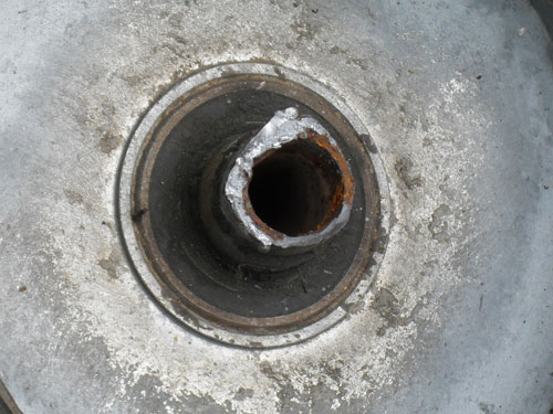

pylon500 Posted November 9, 2011 Posted November 9, 2011 OK, here's a quick rundown, the report goes in tomorrow.. While training EFTO's a (no more than usual) heavy touchdown occurred. Instead of the expected bounce, there was a loud bang whereupon the aircraft pitched onto it's nose and a wingtip causing substantial damage. An undercarriage axle had snapped at a weld junction allowing the wheel to depart (found 150m's away!) and the end of the U/C leg to dig into the grass runway. Picture below shows the cracked end of the axle (still in the wheel), orientation would be top of the axle at about 11 o'clock. The dark grey area (4 to 7 o'clock) is all that was holding the axle together, the brown 'rusted' area is all crack. The shiny, lumpy area across the top, is a really bad weld attempt (probably MIG) where some-one has found a crack and tried to fill it in. There will now follow a period of annoyance as I rebuild my Lightwing. Arthur.
pylon500 Posted November 9, 2011 Posted November 9, 2011 As a side note, if you own a Lightwing, I would seriously consider taking the time to pull off the wheels, clean down the axle at the leg juncture and do a dye penetrant test. This failure has happened before. Arthur.
David Isaac Posted November 9, 2011 Posted November 9, 2011 Arthur, I am so sorry to hear that mate, your little Lightwing was looking so good at Gloucester on the weekend. I am curious, just how legal is it to weld a cracked axle and shouldn't any weld be xrayed or at least carried out by a certified welder. Also a very interesting scenario given the previous owner. I guess you will be asking someone some hard questions.

pylon500 Posted November 9, 2011 Posted November 9, 2011 There's actually an entry in the maint. log describing other repairs nearby, and quoting the repairer, but nothing about the axle. As for work by certified welders, I'm a little unsure if certified (25-55-24) RAAus aircraft require this, or if it's just whether the final L2 is willing to accept the work and sign the log? As for the previous owner, I'm a little more unhappy at the manufacturer for not upgrading the material as the aircraft 'grew', and for not letting more people know about the problem. My original club had the same failure years ago on serial #5, I though that by #83 things would have improved..... Don't get me wrong, the Lightwing is a great plane and I can't wait to get it back in the air, but I will be doing a lot of close looking while I rebuild. Arthur.

Teckair Posted November 9, 2011 Posted November 9, 2011 OK, here's a quick rundown, the report goes in tomorrow..While training EFTO's a (no more than usual) heavy touchdown occurred. Instead of the expected bounce, there was a loud bang whereupon the aircraft pitched onto it's nose and a wingtip causing substantial damage. An undercarriage axle had snapped at a weld junction allowing the wheel to depart (found 150m's away!) and the end of the U/C leg to dig into the grass runway. Picture below shows the cracked end of the axle (still in the wheel), orientation would be top of the axle at about 11 o'clock. The dark grey area (4 to 7 o'clock) is all that was holding the axle together, the brown 'rusted' area is all crack. The shiny, lumpy area across the top, is a really bad weld attempt (probably MIG) where some-one has found a crack and tried to fill it in. There will now follow a period of annoyance as I rebuild my Lightwing. Arthur. Sorry to hear about your misfortune Arthur. We were told there is a AD to put a solid steel insert inside the hollow axels on the Lightwing which is what we did, it was just a bit of solid bright mild steel rod available from most engineering shops. Regards Richard.

Patrick Normoyle Posted November 9, 2011 Posted November 9, 2011 Arthur, thanks for the open and honest post regarding the incident, so many times pride gets in the way of the truth and the real safety issue goes by the way. I hope you can get your girl up and running very soon. As for the welding, i would have thought that any crack would have been best replaced and not patched with a fill weld, there is no way of checking where the cracks extend to, how long they have been there and to what extent corrosion has taken it's toll. Also, had the area been heat treated to harden the material after welding ? If you do find out who welded the crack ( if that is what happened ) you know where to shove the broken axel ! ! !
