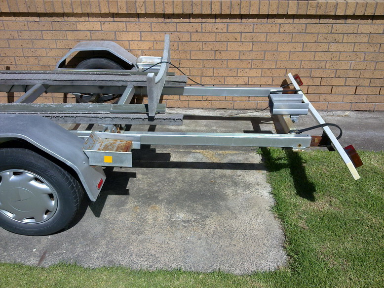

Thruster87 Posted November 10, 2011 Posted November 10, 2011 I found it cheaper to modify an already registered boat trailer[able to carry a 6m boat] Then put slide in and out main wheel supports for just about any track width just aft of the trailer wheels and tail in first by using the boat winch attached to the tail skid/tie down/etc.The length between the main gear and nose is adjusted by sliding the trailer axle via the spring u-bolts.I only carried the fuselage and then the wings separately to the airfield on the craddle siting on topof the trailer in the pic. Hope this gives some sparks to designing yours .Cheers T87 1
