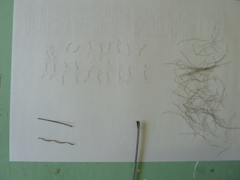

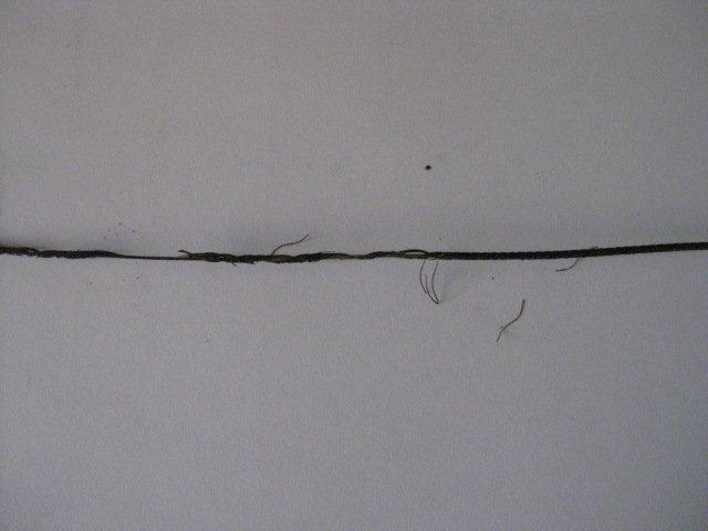

A couple of weeks ago during a daily inspection I found some damage to the port side empennage bracing wire, top side between horizontal stabiliser and the fin, on my T500 Thruster. I have no idea how the damage occurred but this cable was not replaced during the recent rebuild of this aircraft, so I have no idea how old it is. Anyway, the purpose of this thread is to show you the damage once I had unravelled each single strand of wire that formed part of the cable. The cable used is 7x19 3/16" stainless steel, or at least I thought it was stainless steel until the magnetised pointy nosed pliers stuck to a strand of wire!!
This shows the general construction of the cable
This shows what I found once unravelling the cut out damaged section of cable. There are 11 strands (shown top left and centre of photo of wire either broken (9) or damaged (2), so 11 in total. These came from 5 bundles making up the 3/16" cable. The 2 bundles shown left bottom of photo, being the inner most cable and 1 of the cables that twist around the outside, are the undamaged bundles. The 2 damaged strands came from 1 bundle, and the other broken strands came from the remaining 4 bundles. I had no way of inspecting each strand for stretching or distortion - other then running each strand between my finger nails:smile:. Bear in mind that each bundle has 19!! Yes 19 very small filament strands - you can see the pile I unravelled on the right side of the photo. There are 84 strands in that pile; go on, count them!!!

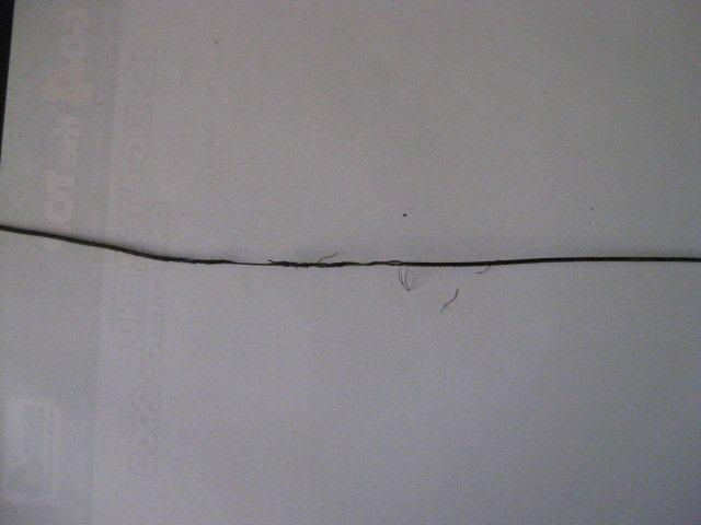

So, by my calculations, and not allowing for any strands that were stretched or otherwise sustained damage I could not detect, 8.27% of this cable was rendered useless. Does this mean the strength of this cable was reduced by 8.27%, or that the cable was still, largely, doing the job?
By the way.... The cable was replaced forthwith.
Unfortunately I did not take a photo of the cable insitu on the aircraft, but I can tell you the damage was not easily visible, but certainly easily detectable by feel. Every accessible flying wire now receives the 'finger' treatment at the daily inspection.

Dunno about your calculations but I agree that only once does one ever have to find a broken strand (OUCH!) whilst running their fingers down a control/support cable and, from then on - forever, I wager they will very, very carefully inspect (and respect the importance of) cable stranding during pre-flight inspection. A pierced finger (which ultimately could avert a busted rectum), proves to be a very cheap 'heads-up'. cheers
Can't remember the calculations required to establish cable strength, but I looked up my book and found this where it said -
When broken wires are detected, the number and position, along with the examiner's opinion of the general rope condition, will decide whether or not the rope should be discarded.
If local concentrations or groups of broken wires are found, the rope should be discarded when:
a)Three or more broken wires are found in the close proximity of the termination,
b)Three or more broken wires are found in one strand or
c)Five broken wires are found between two adjacent strands within a length of 10 x rope diameter.

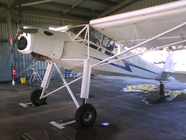

And whilst we are on the subject of cables...and thanks Pud for starting this helpfull thread. I recently was asked by one of my customers with a very early Slepcev Storch to look at an engine problem he was having. His complaint was that the engine RPMs would flucuate at mid and high range with no movement of the throttle.
I did my usual Rotax recommended checks of the carb adjustments and made some fine adjustments, but found nothing major. The carb mount rubbers were old and I suggested he order a new set for replacement. I then conducted some ground engine runs and although there was some small variations, all sounded normal and I put those down to the wind blowing through the 3 blade prop.
I then conducted a test flight ( never knock back Storch time !) and all seemed normal and strong with the engine.
to my surprise a week later the owner Emailed me the following photos of a carb cable he had found during fitting of the new mount rubbers. After buying the aircraft some years earlier he had fitted new steel cables instead of Stainless cables. Things rust quickly in the humid tropics and this cable didn't have far to go before failure ! Could have been exciting had it let go in flight...................................................................Maj...024_cool.gif.7a88a3168ebd868f5549631161e2b369.gif
