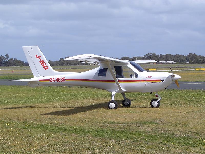

BigPete Posted April 10, 2007 Posted April 10, 2007 I too am pantless (look Ma no spats!) Doesn't seem to make any difference (J160c) I'm cruising at 2800 revs and about 92/93 knots ASI. regards

BigPete Posted April 12, 2007 Posted April 12, 2007 Guys - I was disappointed in the quality - cost me around 150 aussie dollars including freight. Make your own either 'glass or spun aluminum.
BigPete Posted April 12, 2007 Posted April 12, 2007 Captian - boy your quick - as far as I can tell NOTHING. But it looks good. regards
