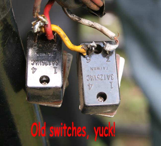

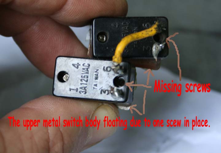

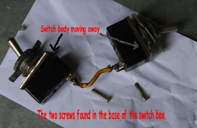

Once home and armed with a new set of switches I dismantled the small switch box to find that the switches are held together by 2 very small screws in each switch body. On both switches one of the small screws had vibrated out leaving the switch only just working. I'll post pics because a pics worth a thousand words and Im long winded enough lol.
Like I said Im not sure if the faulty switches were originals or changed before my time? Either way its worth a look at your own on that windy or rainy day.
Im now back to a three or less pulls to start, Yaaaa!
PS, who ever soldered in the old switches needs to leave the soldering to someone else. Seeing this nasty mess makes me think even more that they aren't the originals?

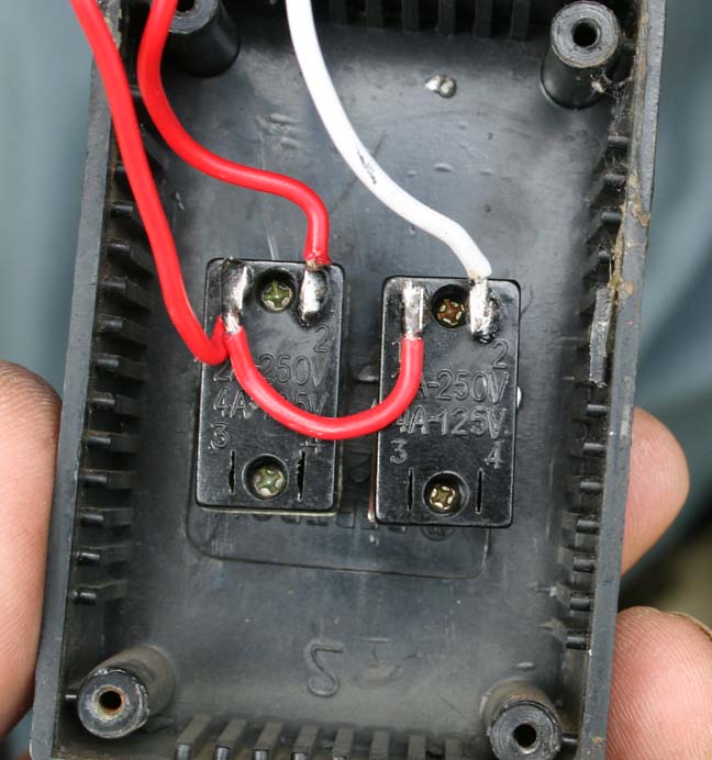

Thanks for your input av8vfr. You had me scratching my head wondering how the hell you knew the amp of the switches I put in and then it dawned on me DOH!
I should have posted one more photo and then you would have had the whole picture.
On the bottom of the old switches it reads 3A125VAC on the bottoms of the new ones it reads 2A-250V and 4A-125V
I did remover both screws on both new sets and loctite the screws in.
