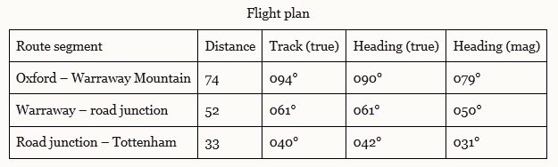

3. Calculate the true heading, remembering that the wind correction is applied in the direction the wind is coming from; so that:
(a) Segment 1: wind is from the left, correction angle is 4° and the heading is 094 minus 4 = 090° true.
(b) Segment 2: wind is from dead ahead, correction angle is 0° and the heading is 061 minus 0 = 061° true.
© Segment 3: wind is from the right, correction angle is 2° and the heading is 040 plus 2 = 042° true.
4. Convert the true headings to magnetic headings. There is an isogonal passing through the chart in the route planning module (the dashed purple line), which indicates the local variation is 10½°E. Applying that to our true bearing — remembering our aide-memoire "variation east, magnetic least" — and we have the following headings: 079°, 050° and 031° magnetic.

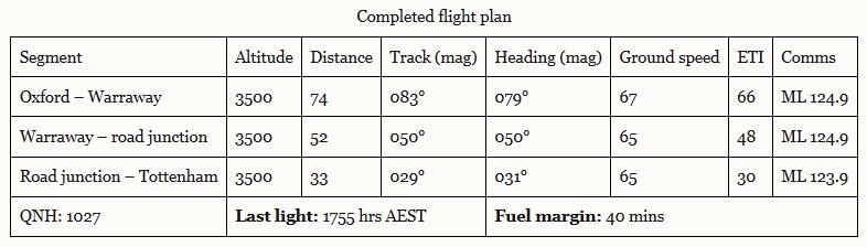

(a) Segment 1: distance = 74 nm; speed = 67 kn: 74/67 × 60 = 66 minutes.
(b) Segment 2: distance = 52 nm; speed = 65 kn: 52/65 × 60 = 48 minutes.
© Segment 3: distance = 33 nm; speed = 65 kn: 33/65 × 60 = 30 minutes.
Sum the segment ETIs to produce the estimated time en route [ETE]: 144 minutes.

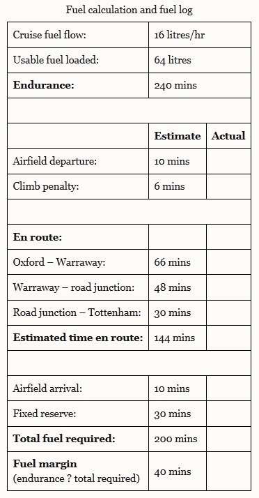

7. Calculate the total fuel needed including:
(a) The fuel consumed from start-up at the departure airfield to the set-heading point (10 minutes)
(b) Extra fuel consumed in the climb (two minutes per 1000 feet = 6 minutes, refer to fuel planning)
© The summed ETIs (144 minutes)
(d) Fuel consumed in the circuit and landing at the destination airfield, including an allowance for delays in the circuit (10 minutes)
(e) The fixed 30-minute reserve (see Note 1 below)
The total is 200 minutes — well within our full fuel endurance of 240 minutes and giving us 40 minutes margin on top of our fixed 30-minute reserve. We will use the fuel log during the flight.
