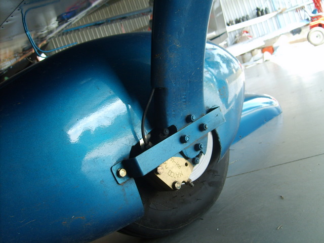

eightyknots Posted December 30, 2011 Posted December 30, 2011 best of both worlds? I have often thought about this kind of arrangement but I have never seen one until you posted this picture. I'm sure it must add a few knots to cruising speed for no extra fuel. What plane is this on?
fly_tornado Posted December 30, 2011 Posted December 30, 2011 they where on a yak 54. although that photo is a giant RC model.
