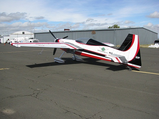

djpacro Posted January 20, 2012 Posted January 20, 2012 I spent some time with him recently. Photo attached is his aeroplane as it is now. His new wing is a big and ambitious project. Leo Loudenslager was working with Zivko on a new design at the time of his death - the aeroplane is in a museum now but some feature have been incorporated into aeroplanes flying now. http://www.airventuremuseum.org/collection/aircraft/Loudenslager_Zivko%20Shark.asp I wonder if Matt has seen this one: http://www.esotec.org/hbird/index.html Incidentally, the Laser is a very nice aeroplane to fly and easy. 1
