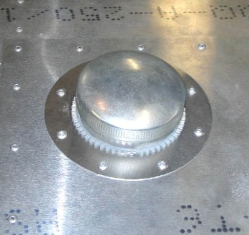

Try this as an idea16746-186aa7b7aa947437729b15c91c0729ea.jpg639688624_FuelTrim16.jpg.01b26872072a449702a9011c60188d42.jpg
This is a complete seal which is water tight cut with cnc machine and a neoprene washer.
cheap too. I've used this fellow to make some things for my 701

Try this as an idea16746-186aa7b7aa947437729b15c91c0729ea.jpg[ATTACH=full]16746[/ATTACH] This is a complete seal which is water tight cut with cnc machine and a neoprene washer.

Terry do the fuel caps screw on to the existing filler caps ?I can see that they are put on with screws on the outside,they look like a good solution.Thanks Sam
