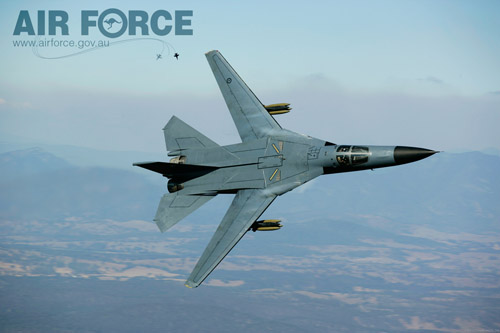

Guest GraemeM Posted February 14, 2012 Posted February 14, 2012 Or you could go the swing wing way, seems to have been working ok for a wile now.

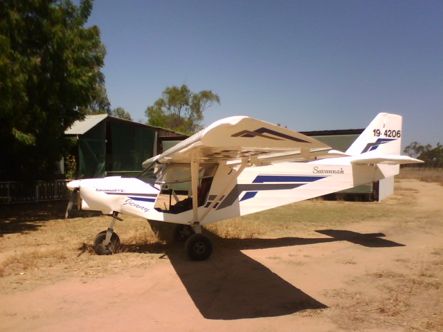

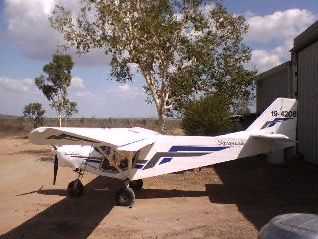

sain Posted February 23, 2012 Posted February 23, 2012 Oh, I forgot to mentiont that the reason why Hornets, CH701s and Savannahs are all only-their-owner-could-love-them ugly is because they are built to be draggy as all hell so they'll slow down fast. This allows them a steeper approach angle and shorter run-out on landing. If your just after Short Take Off performance you can do away with a lot of that and go for a lower drag fuselage. Take a look at some of the really small single seat low wing aircraft (hummelbird, CriCri etc etc). Take off distance can be suprisingly short, given they are not designed specifically for it. Cruise speed is pretty decent on those as well. Its amazing how fast you can get off the deck with a decent power-to-weight ratio.

David Isaac Posted February 26, 2012 Posted February 26, 2012 Quote Oh, I forgot to mentiont that the reason why Hornets, CH701s and Savannahs are all only-their-owner-could-love-them ugly is because they are built to be draggy as all hell so they'll slow down fast. This allows them a steeper approach angle and shorter run-out on landing.If your just after Short Take Off performance you can do away with a lot of that and go for a lower drag fuselage. Take a look at some of the really small single seat low wing aircraft (hummelbird, CriCri etc etc). Take off distance can be suprisingly short, given they are not designed specifically for it. Cruise speed is pretty decent on those as well. Its amazing how fast you can get off the deck with a decent power-to-weight ratio. Not quite that simple Sain, Removing the draggy bits off a Hornet, or Savannah, wont make it go any faster. Most of the ugliness that you refer to is built in for strength because STOL aircraft typically land in rugged country and land on surfaces that would destroy a Jabiru, Tectnam etc. The maximum speed of a STOL aircraft is limited by a combination of drag and loading; of far more importance is the loading at speed. What many don't realise is that a high lift low speed wing suffers much higher loads at speed than a low lift high speed wing. Most of the STOL RAA aircraft due to impractical weight limitations cannot build in enough strength to allow cruise speed more than 90 to 95 knots, but these same aircraft can safely do a landing approach at 40 knots or less under a properly controlled short field technique. Adding power will certainly decrease takeoff distance simply from the aspect of greater acceleration. Higher power will allow you to overcome the drag at low speed to have a very impressive climb rate, but it will NOT increase your cruise speed without exceeding the load limitations of the wing. Yanking the stick back on any aircraft to take off earlier than normal is a very dangerous technique unless you really know what you are doing. Plenty of people have met their maker doing just that. 2
