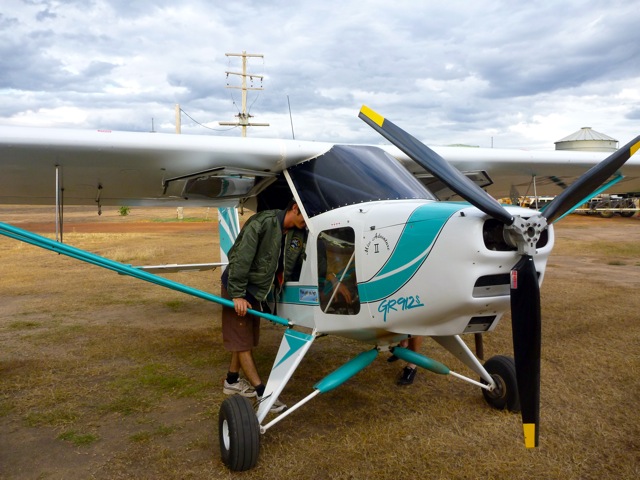

kaz3g Posted February 19, 2012 Posted February 19, 2012 She's pretty as a picture, Maj! If I lost my medical I'd look at one like this as a serious alternative. I think they are a very well made and honest little aeroplane and they seem to sell at a realistic price. kaz 2
Guest Maj Millard Posted February 19, 2012 Posted February 19, 2012 All true Kaz..and a heap of fun to fly also. Probabily not a lot of difference to a good Auster!..Great photo taken whislt on curving final at Tomos' Cecil Plains strip. I'd either come from Casino or Dingo roadhouse. Hope to drop in again on the way back from Temora at easter.......................................................Maj...

Guest Maj Millard Posted February 24, 2012 Posted February 24, 2012 Bones, Quertys' machine has been in the used aircraft section in the RAus mag several times now. It is Ref no 1987. It's an older one but has a 912 and looks pretty clean...If you go to the RA Aus home site you should also be able to access it under used aircraft......Ivo-props: you might try Wade Air in Orange (Wade Marlo)............................Cheers Ross Attached: a photo of the Powerfin 3-blader on my LW....that's Tomo with his skinny little legs try to flog some of my instruments !!!

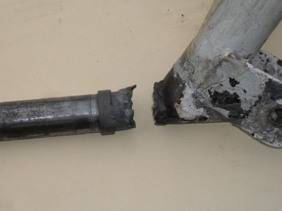

pylon500 Posted March 2, 2012 Posted March 2, 2012 Another point worth inspecting is the base of the wheel axles. Remove the wheels and look VERY closely at the top of the axle between the bearing collar and the welds to the legs. Dont get me wrong, these are great planes, but this is something to watch for... Arthur.
Guest Maj Millard Posted March 2, 2012 Posted March 2, 2012 Hi there Arthur, I have a list of things that I need to check on the Lightwing, prior to flying to Temora at Easter. One of the things on the list is 'check main wheels and axels' so your photo is of some interest to me. I've meet Terry who hads done a lot of the welding for Howie, and prior to that Johhny Herd. Both are pretty damn good with the welding stick !.... Do you have any more info re; the photo, such as age of aircraft, TT in service, and had that axel been previously damaged and repaired ?.....the weld in the photo looks like it may not have been a factory weld. was the failure the result of an incident. Cheers mate...........................Ross Millard

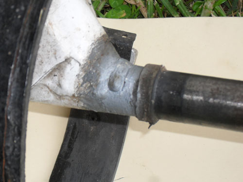

pylon500 Posted March 4, 2012 Posted March 4, 2012 G'Day Ross, You are right in that there was a weld repair at the point the axle broke. Why it was re-welded is unknown, nothing in the logs, but it had been welded on both sides, see photo; This is the other side and was only found after the accident. The reason I comment is that about 20 years ago, we had the exact same failure occur on our club GR582. Examination of the axle showed that it had been cracked for some time, we suspected since new, but being on top of the axle, it was being held closed by the weight of the aircraft. The crack propagated over the years until a slightly heavy landing caused it to fail (same as mine). That GR582 was serial #5, mine is #83 and still had the thin wall axle and no solid plug inside? Some axles look solid, but actually have blanks welded on the ends (like mine). Something to watch for...... Arthur.
Guest Maj Millard Posted March 4, 2012 Posted March 4, 2012 Thanks for that Arthur, that'll make my inspection more interesting. I'll get to it in a couple of weeks. So the later ones had a solid plug in them did they ?...so it should run beyond the weld area ? Mine is serial 140, a 2000 model so it will be interesting what Ifind...............Cheers and thanks again.....................................Ross
