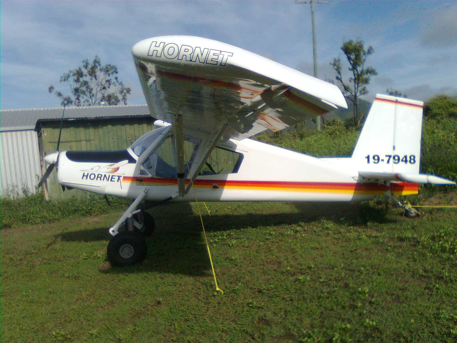

Guest Maj Millard Posted February 26, 2012 Posted February 26, 2012 Brand new Hornet 19-7948 which arrived at Montpelier last weekend from taree, suffered an engine stoppage today and sits in a grassy field near the Ross River dam, not far from home base. Appears the pilot was switching fuel tanks enroute. From reports he turned the old tank off, and didn't select the new tank quick enough, resulting in fuel starvation to the engine. The correct proceedure by the way, is to turn the new tank on first, and then turn the old tank off !....Don't know what height he was when the stoppage occurred, or if an inflight restart was attempted. From a flyover it appears the left undercarrage has collapsed, and there is also LH wing damage. The two occupants escaped unharmed.............................................................Maj...
Tomo Posted February 26, 2012 Posted February 26, 2012 Ooops! Bet he won't do that again Glad there weren't any injuries
kaz3g Posted February 26, 2012 Posted February 26, 2012 Brand new Hornet 19-7948 which arrived at Montpelier last weekend from taree, suffered an engine stoppage today and sits in a grassy field near the Ross River dam, not far from home base................Maj... That will hurt in so many ways. Maj. Hard to bend an aeroplane anytime, even harder if it's new and harder still if it's your own fault. Quite a lesson, I guess? Still, the positives are that the occupants are ok and the aircraft can be rebuilt. kaz
Guest Maj Millard Posted February 26, 2012 Posted February 26, 2012 No it was a side by side seat job with a 912uls up front. Yes it did look rebuildable from my fly-over, so the owner will have something to do with his time for a few months, yes she was brand new, and yes always good when nobody gets hurt. Nice looking machine..pity.....I have some photos of the aircraft pre, and post-crash, which I will post later this evening................Maj...

Guest Maj Millard Posted February 28, 2012 Posted February 28, 2012 I'm happy that my original post has spurred a good discussion of fuel systems, which is always good. Let me say at this point that I don't think the design of the Hornet fuel system had anything to do with this incident. I know Olies' workmanship, and he designs and builds a fine, and capable aircraft. In answer to biggles question...I suppose there is no drama in having both tanks always on. There should however be a way to turn off fuel to the engine, for various reasons. Most aircraft give the pilot the choice to draw fuel from a selected tank, and to alternate between tanks. For instance the Lightwing has, like many other aircraft, a tank in each wing plus an auxilary long-range tank (20 lts)below the fuselage. This aux tank pumps up into the RH tank only, when required. So after take-off with both tanks selected (as with landing), I'll draw initally from the RH tank, then alternate every 30 mns between L and R. When 20 lts has been used from the RH, I can then pump the fuel up from the Aux. Often one wing tank will draw quicker than the other, so alternating tanks allows the pilot the option of keep similiar quanties in each tank, or to drain one more than the other, for lateral balance. This is especially handy if your flying solo in a side by side aircraft. I rarely drain a tank dry, and always attempt to land with similiar amounts in each side.................................................................Maj...
