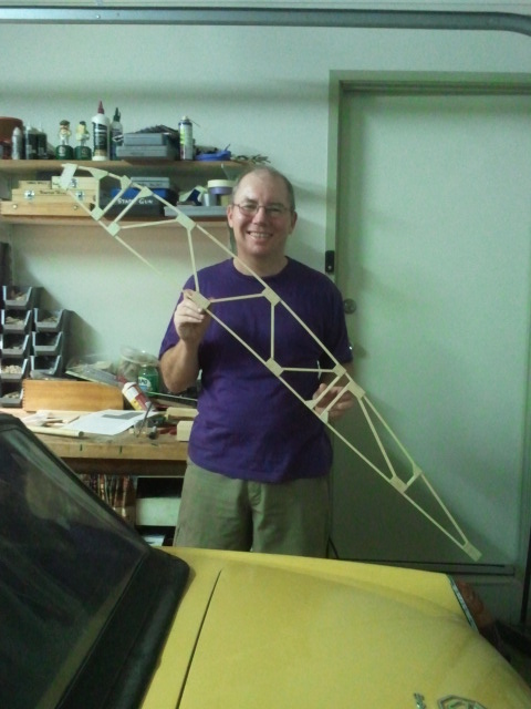

Piet Fil Posted March 13, 2012 Author Posted March 13, 2012 Well Rib 1 has been glued and gusseted and is out the jig. Only 31 more to go. Fairly happy with how it turned out as the grin shows. Gusset cutting tip if you are using strips and not the hole saw method: once your strips are cut, use masking tape to tape 10 strips tightly together, mark out the top one and cut them 10 at a time on the band saw or with a good sharp handsaw (use a japanese razor saw if you have one; I'll post a photo of one in the gallery later) Phil 2 1
eightyknots Posted March 14, 2012 Posted March 14, 2012 Well Rib 1 has been glued and gusseted and is out the jig. Only 31 more to go.Fairly happy with how it turned out as the grin shows. Gusset cutting tip if you are using strips and not the hole saw method: once your strips are cut, use masking tape to tape 10 strips tightly together, mark out the top one and cut them 10 at a time on the band saw or with a good sharp handsaw (use a japanese razor saw if you have one; I'll post a photo of one in the gallery later) Phil [ATTACH=full]16789[/ATTACH] Nice first rib, Phil. PS: I recognise the unmistakeable shape of a mid-1960s MGB in the foreground.
Piet Fil Posted March 14, 2012 Author Posted March 14, 2012 Well Guessed 80knts, its a 1968 MGB. A present from my lovely wife. Lucky me
