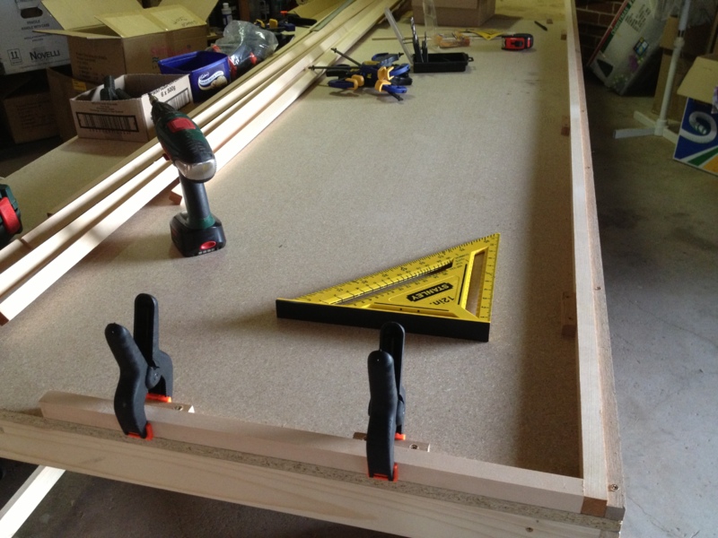

Well, after a bit of project hiatus, I kinda got distracted moving house and building a round yard for our horses.
I finally got around to ordering some spruce from Tom and then today drove up to Newcastle to pick it up. the picture shows the 8' and 10' long 2" thick pieces of spruce. The picture doesnt show the long pieces that were on the roof rack (two 19'x6"x1" and one 16'x7"x1").
Now, after I re-jig the garage tomorrow it will be time to build a bench for empennage construction and then start machining timber to sizes.
Joy o joy, 012_thumb_up.gif.cb3bc51429685855e5e23c55d661406e.gif building time again

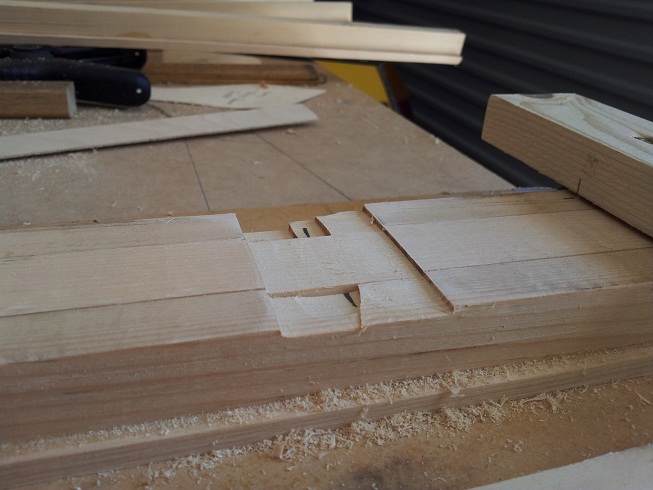

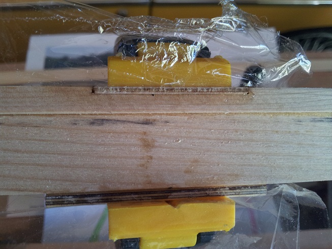

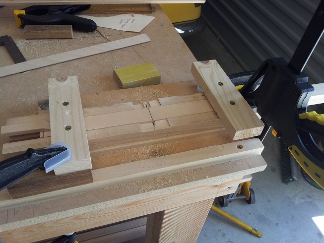

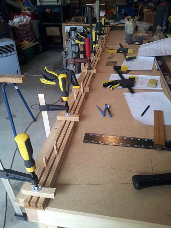

Been busy machining the Empennage timber and laminating the main beams, leading edge and trailing edge. Also rebated the main beams to insert some ply reinforcing where the hinge eyebolts are to go through. Next job will be jigging up the Horizontal Stabiliser and fitting all together before gluing up.

Some more photos added to the album showing eyebolt hinges, nutplates for hinges and tapered horizontal stab end pieces. Should be guing up the Horizontal Stabiliser this arvo/ tonight

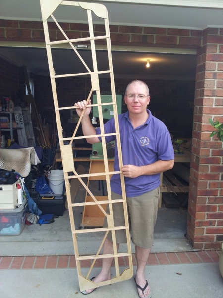

The bits are getting larger. the almost finished Horizontal Stabiliser. (Please ignore the safety thongs in the workshop)

Looking good Phil:thumb up:jason
It must feel great to make this milestone. Are you weighing each bit? Very useful practice. Your elevator looks about one kg.
Hi Phil...looking good mate! Keep going with it. Your doing the same as I did. Build the smaller bits first then when the fuselage is built, it goes together pretty quickly. About to take my fuselage off the build table!
