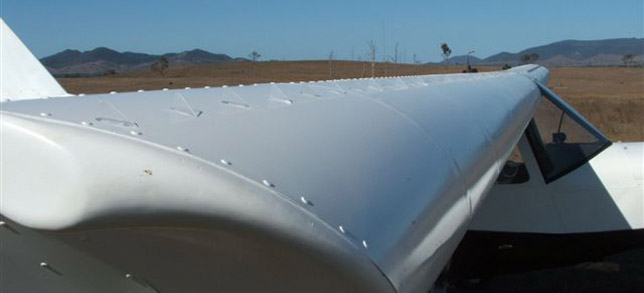

eightyknots Posted March 16, 2012 Posted March 16, 2012 I was reading -on another website based in the USA- that there appears to be a brittle Vortex Generator (VG) problem with aircraft over 300 hours. The VGs in question are ones supplied by the Savannah factory. Question 1: Has any Savvy owner of 300+ hours vintage experienced any problems with their VGs breaking off like the ones in the picture below? This seems to be an issue particularly where aircraft operate in temperatures below +5 degrees Celsius. This leads to another question: has any Savannah builder decided to chuck out the ICP-supplied VGs and use the Stolspeed-made ones instead? (see stolspeed.com for comprehensive details on Australian made VGs)
Ultralights Posted March 16, 2012 Posted March 16, 2012 our VG now has 800 hrs on it, and the only ones broken are in front of the fuel fillers, caused by fuel lines and jerry cans hitting them.

dave66 Posted May 30, 2015 Posted May 30, 2015 I was reading -on another website based in the USA- that there appears to be a brittle Vortex Generator (VG) problem with aircraft over 300 hours. The VGs in question are ones supplied by the Savannah factory.Question 1: Has any Savvy owner of 300+ hours vintage experienced any problems with their VGs breaking off like the ones in the picture below? This seems to be an issue particularly where aircraft operate in temperatures below +5 degrees Celsius. This leads to another question: has any Savannah builder decided to chuck out the ICP-supplied VGs and use the Stolspeed-made ones instead? (see stolspeed.com for comprehensive details on Australian made VGs) [ATTACH=full]16820[/ATTACH] I made a mould and made my own using a hot glue gun,my VG has 380 hours but I believe its UV that makes them brittle then when its windy the covers break them off

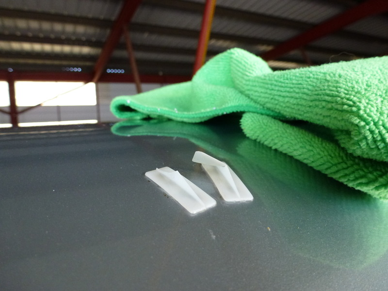

Ultralights Posted May 31, 2015 Posted May 31, 2015 i replaced the stock ICP VG's with Stolspeed ones. the originals lasted 1000Hrs, and had a few broken ones, probably every one from around the fuel caps, to the wing root were broken, no noticeable reduction in performance. i used a heat gun to remove the old ones, as they were stuck on with sikaflex, then lightly sanded the paint, cleaned and degreased, and stuck the new stolspeed ones in the same locations. (i pre-painted them with polyeurethane while they were on the backing sheet) 1
