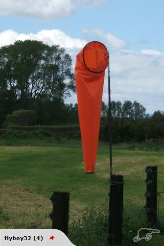

This is an advert running in New Zealand (yes, I know that this is 5,500 km away). It should give you an idea of price (about $AUD80.00) and availability. There is also some useful info on windsock frames you may be interested in. I understand that these people export them to Oz so, if you are stuck, you could give them a ring.
Windsock $95 inc gst
Made from Fluro Orange PVC - 400mm opening - made for small airfields - factorys - farms - heliports - hospitals any use you can think of...
Windsock only $95 inc gst
Windsock Frame (Stainless) $195 inc gst
Extension pole not included.
Stainless steel 400mm opening - tested and stengthened over the past 8 years.
95% maintenance free -only a small touch of grease required every few years.
Used by many small Microlight fields and Industry.
Full size windsocks made to CAA specs also available- any custom size made on request.
Call Barsal Aircraft covers 07 829 7520

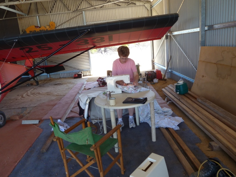

I have an old fuselage sock from my T500 so I could use that. I'm no good on a sewing machine but Gay is very good, so I could get her to modify the fuselage sock for me. What are the dimensions of your windsock farri?
Here's a photo of Gay sewing up some old sheets for tail skins covers.
Pud

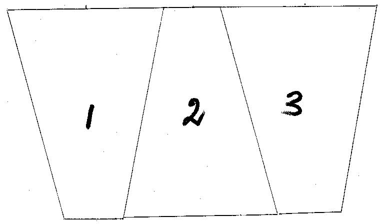

Another good idea farri! thanks...What are the dimensions of your windsock farri? Pud
Pud, I don`t remember exactly, I`d have to go down and measure it but the dimensions are not that imortant, Just make it up to what suites you and work around the amount of material you have.
For the least amount of waste and the easiest way to make it, cut the pieces the way I`ve shown! the amount of pieces required depends on the diameter you choose! 4 or 6 pieces,then sew together.
You can make the big end stronger by sewing some extra material, say about 50 m/m wide to it or you can roll back the end so that you can run some cord through it then you just cable tie it to your frame.
