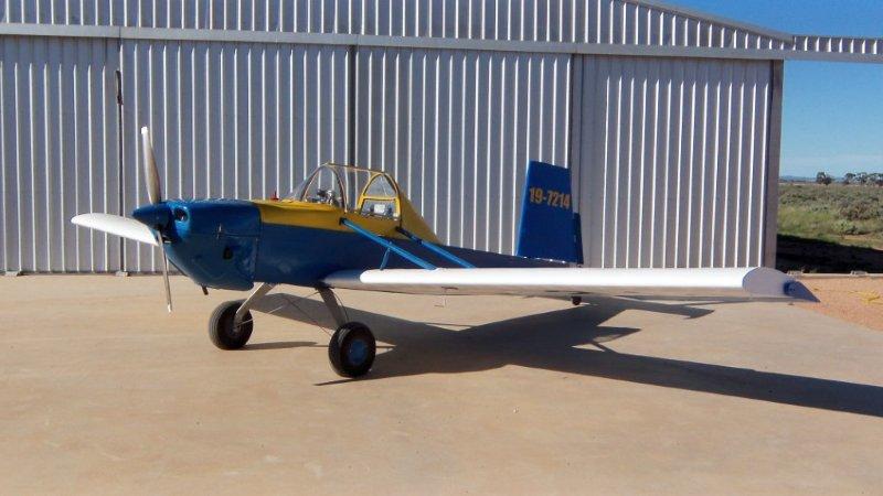

Guest ron dunn Posted March 26, 2012 Posted March 26, 2012 The bird being my Evans VP1 that took almost 5 years to build ( make that read refurbished) First flight was on Monday 26 March for a duration of .7 hours and all went well. When I purchased the aircraft it was in a sorry state, having been stored for well over a decade and the engine had been sold. The restoration went well with a big time delay in the WV conversion that I purchased. It was not up to scratch so I canned it and installed a low hour Jabiru 1600. I am glad I did as I now have a quiet running engine with electric start and it produces as much or more power than the 1600 VW would have. The aircraft has a turtle deck and full canopy and looks quite neat with the Jabiru style cowl. Climb rate at this early stage looks to be around 450 - 500 fpm and may improve a little when I finish the wing root fairings. Indicated airspeed shows 80 knots at 2850 rpm so am fairly pleased at this stage. To all those that are still building - keep at as it is really worth it! Cheers Ron

Guest ron dunn Posted March 27, 2012 Posted March 27, 2012 Hi all. Finally got a photo below to have a look at. Will try and get a photo of the bird in it's sad and sorry state when I first picked it up. Cheers Ron

planedriver Posted July 30, 2012 Posted July 30, 2012 Well done Ron, it looks great mate, especially with the full chipmonk like canopy. Hope you get many, many hours of safe flying fun as a reward for all your hard labour. Rgds Planey
