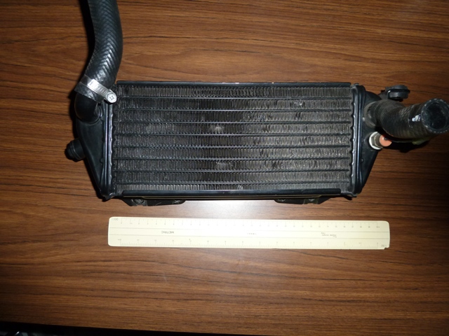

I visited a motorcycle wreckers today and parted with $75 to get this....
I'll fit it similar to how SAJ has configured his setup.
I think it will work very well, although the extra cooling area it gives me is 264cm2, when I only require 166cm2. I'll play with that once I see how it affects the operating temperature.
What do you think?
Pud
Should do the trick. I wouldn't worry about it being bigger than you need ( in theory). You would probably get a NEW one off on of those little chinese bikes for the same price. ( next time eh).. Nev
