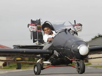

solomon Posted April 11, 2012 Posted April 11, 2012 hi everyone, I'm building an ultralight plane from scratch and I’ve installed two motors and thinking of putting a third one on all under one throttle. The plane so far weighs 89kg empty and by the time I’m done it will be around 126kg empty with a gross take-off weight of about 191kg. It's now also got an 8m wingspan. Does anyone know what category it can be registered under hopefully one that doesn’t require a sports pilot licence and allows multi engine?? Please if you have any information I’ll be more than happy to listen Thank you Solomon Old image below:
David Isaac Posted April 11, 2012 Posted April 11, 2012 Hi Solomon, The only category that allows more than one engine in the Recreational Aviation category is CAO 95-10. 95-10 has a max take off weight (MTOW) limitation of 300Kgs, is limited to single seat and has a maximum wing loading requirement (that I cannot remember off the top of my head) which ultimately determines stall and cruise speeds. Most of us regard 95-10 as the ultimate experimental category as long as you stick to the basic rules as stated above and in the CAO. If you had the money you could put a full 'suck, squeeze, bang, blow' turbine or several if you can stay below 300Kgs MTOW.

solomon Posted April 12, 2012 Author Posted April 12, 2012 Quote Hi Solomon,The only category that allows more than one engine in the Recreational Aviation category is CAO 95-10. 95-10 has a max take off weight (MTOW) limitation of 300Kgs, is limited to single seat and has a maximum wing loading requirement (that I cannot remember off the top of my head) which ultimately determines stall and cruise speeds. Most of us regard 95-10 as the ultimate experimental category as long as you stick to the basic rules as stated above and in the CAO. If you had the money you could put a full 'suck, squeeze, bang, blow' turbine or several if you can stay below 300Kgs MTOW. Thanks David that was very helpful, I’m sure I can stay within the regulation no problem, just hoping you wouldn't need a sports pilot licence to fly them.
David Isaac Posted April 12, 2012 Posted April 12, 2012 Quote ..... but someone told me if you want to register a twin engine you have to have them under one throttle so they’re counted as a single engine aircraft. .... Not the case Solomon, you would be surprised how many do not know you can have multi engined 95-10 ultralights.
David Isaac Posted April 12, 2012 Posted April 12, 2012 Quote Thanks David that was very helpful, I’m sure I can stay within the regulation no problem, just hoping you wouldn't need a sports pilot licence to fly them. No worries buddy, all you need is an RAA Pilot Certificate to fly 95-10 registered aircraft regardless of the number of engines. However, you would need to be very careful in an unproven multi-engine configuration as to the effects of asymmetric control. I would suggest you need to get this thing test flown by someone else and be properly trained in engine out ops my friend, we don't want anything to happen to you do we ..... 2
