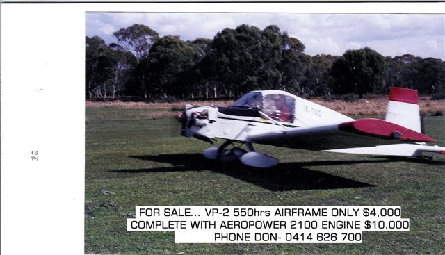

Methusala Posted May 1, 2012 Posted May 1, 2012 You'd probably be a bit disappointed with the performance of a Volksplane. I have one which I flew for 11 years from 1995. It's a VP-2 but quite heavy (built like the proverbial brick ****house). Strong and with a 2100cc VW flies alright - 60kts at 3200, 18l/hr. Climb is a bit gradual- 400fpm at 2500 field elevation. It was a good roomy single seater which 2 blokes (not over 70kg) could fly on a good day from about 1000ft elev. Great plank of a wing stall 32kt and powerful elevator and rudder but heavy and not too effective ailerons. It has an enclosed canopy but still looks about as pretty as a bitsa. Strong as hell and taught me a lot about flying - even thermalling. Picturebelow. Cheers, Don
