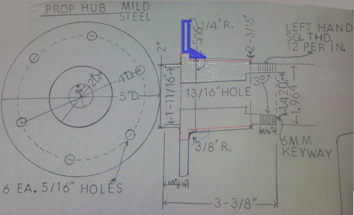

Pilot Pete Posted April 21, 2012 Author Posted April 21, 2012 I've read Bob Hoovers blog and downloaded a copy of the plans/specs for a hub and could possibly lathe one up myself on a neighbours lathe . Still, if I could buy one already made and ready to bolt on I would prefer to go that way. Where did you buy yours?

spacesailor Posted April 22, 2012 Posted April 22, 2012 I tried to upload a pic but its too large! So here's txt| On the plans, the hub is one piece steel, I would try to make it two, by making the drive hub fit TO a collar before the prop spigot. Save a very large / heavy steel blank . and use alloy with the steel baking plate. spacesailor
Pilot Pete Posted April 23, 2012 Author Posted April 23, 2012 Very similar to Bob Hoovers. He made his flange sepperate too and welded them together front and back. He then spun the assembly on a lathe and machined the hub up true. Flange was mild steel and the spigot was made in 4130
