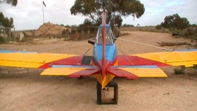

flyerme Posted April 30, 2012 Author Posted April 30, 2012 OK just finished a static balance,and perfect!! with 1/2 fuel and 70kg pilot it sits level at 14.2" if moved to max aft 16" it balance's nose down slightly,set at 12"max forward and balance's slightly tail down. NOT a c of g prob? any other ideas?
Deskpilot Posted April 30, 2012 Posted April 30, 2012 Do you have a balanced elevator? If so, is the balance correct? Can anything at the arse end move whist under the influence of prop wash? Just thinking out loud.
flyerme Posted April 30, 2012 Author Posted April 30, 2012 ok found something causing my "running out on back stick",my bad I put a rubber stop because when full back the control arm hit the back wall and has rubbed a dent,any way removed it (a good 3 mill thick) and replaced with tyre tube cut out,but still doesnt explain needing 1/2-3/4 back stick as soon as she pitch's over? thinking about last flight it feels like not enough air flow over tail unless power applied, will test next chance to see if in level fight at 60 knotts with centre stick,if i back off power see if she will nose over,but already notice in level flight at 60 knotts stick is centred but on approach at 60knotts(less revs) she need 1/2=3/4 back pressure and if you throttle up(as the elevator already 3/4 up) she instantly gets more airflow and lifts,,im really thinking airflow?
flyerme Posted April 30, 2012 Author Posted April 30, 2012 may have found the cause? any one know about trimming tabs? it has 2 small trimming tabs on elevatot trimed down..I guess to keep it hand free in level criuse? but what happens in approach? as these would still be pulling the nose down yeh? and to be clear the stall at landing was all my mistake with the rubber stop on the elevator..as we know the longer the arm the further the travell .. bloody goose.. im ashamed to say without the stop the elevator has a fair bit more travel at the trailing edge..any way back to trimming tabs,,ive never seen these prior the super cat.Note:at some stage it has been set up for long distance flying and has 409hrs on the clock,vhf,gps (arial and wiring),compass ,aviation thermometer,alt/qne/ etc...so it may be set up for long cruise with tabs and not set best for landings ?

flyerme Posted April 30, 2012 Author Posted April 30, 2012 damn.....Just got an email from thr owner of the rightd to the bobcat/supercat plans and here it is. The trim tabs being bent down will give you an up elevator trim condition, the tabs will fly the elevator in the opposite direction of the deflection. Another thing to check is that your ailerons aren't drooped beyond the normal airfoil and acting like flaps. On my Supercat built in 1994 and with over 720 flying hours, I did a couple of things beyond what was shown on the plans. One I added an electric elevator trim tab in the left elevator half, and the second thing that I did was to enlarge the horizontal stabilizer. Both of those modifications worked very well, and when I acquired the rights to the plans the larger stabilizer was incorporated into the plans. I don't remember where your CG is, but I am flying with the CG at 14.8" aft of the leading edge of the wing and have been very happy with it there. Remember that my stabilizer is larger so it will allow a more CG, but I am still well within the recommended range. Cheers, Steve
djpacro Posted April 30, 2012 Posted April 30, 2012 All good. You know more now. The down elevator tab does indeed trim the elevator up but two things to ponder: - the tab reduces elevator effectiveness as well because it produces lift in the opposite direction - your reduced tab deflection means you need to pull harder to get the same elevator deflection but it gives a little bit more elevator authority for the same deflection - if that large tab deflection is needed to trim the elevator for cruise - then where is the elevator in cruise and is that normal? Which leads to his suggestion to check the aileron droop.
