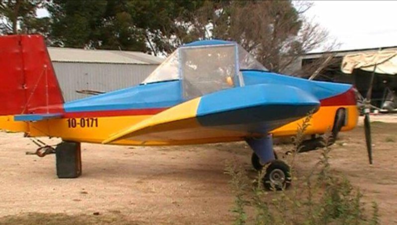

microman Posted December 7, 2014 Posted December 7, 2014 Flyerme - I note you had a Supercat (Bobcat with overwing struts as I recall). I just acquired one that had been sitting in a hangar for 10 years and having tidied it up am about to test fly it. I seem to recall some earlier discussion about Supercats/Bobcats which centered around their longitudinal instability (due to being very short-coupled) - any comment you might care to make could be useful. Mine has a Rotax 503 SCSI (46 hp).
flyerme Posted December 7, 2014 Author Posted December 7, 2014 Hello, yes correct I had the supercat( strutt braced) I had 447 rotax in it and build was from original plans. The original design is vey short coupled with small tail plane and makes for some exciting flying....meaning it is very pitch sensitive and at times unstable with tendency to oscillate on final and as slippery as an eel. The later built versions (by new plans owner -3rd designer) has longer fuselarge tail section and bigger tail plane giving a stable flight. 2nd designer was unfortunatly killed in his modified bobcat. The new plans owner is very helpful and can be found on YAHOO GROUPS " supercat owners" With mine it 3 point landing only- watch the torque roll on take off can bite Note -calm no wind.
microman Posted December 7, 2014 Posted December 7, 2014 Thanks for that flyerme - looks like it was a nice late-evening flight. My aircraft is open cockpit - no enclosure - will make sure there are calm conditions when I try it. 1
flyerme Posted December 7, 2014 Author Posted December 7, 2014 Keep us posted on your flight test...... Open cockpit - cool. I Love my hair flowing in the wind.. And by hair I mean as in 1 strand- that's all that's left. Good luck:helmet:
