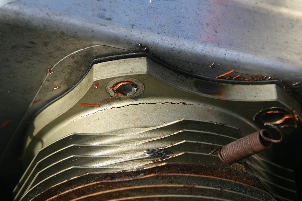

motzartmerv Posted May 1, 2012 Author Posted May 1, 2012 For those that are interested, heres what the cylinder looks like when this occurs. 1

eightyknots Posted May 1, 2012 Posted May 1, 2012 Quote Hi guys. Here's a flight path mock-up. Props to Motz, he's taught me everything I know. I hope you all have as good an instructor as I do.Cory. [ATTACH=full]17398[/ATTACH] So glad you weren't over tiger country and that you're both OK! Quote For those that are interested, heres what the cylinder looks like when this occurs.[ATTACH=full]17404[/ATTACH] Ouch, that looks both nasty and costly!
jetjr Posted May 1, 2012 Posted May 1, 2012 My 2 cents on the photo Motz The problem with the normal through bolts was thought to be that during normal tensioning the first threads can strip. Adding longer nut adds more threads so in theory more hold on the bolt. Not sure I agree though. It seems in this case the entire threaded end has let go, based on the crack appearing on this side of the cylinder its possible the bolt was the secondary event. Heavier bolts may not have helped. Looks awfully like detonation could have caused this. Did the engine suddenly stop? Did you have EGT equipment fitted? In terms of repair, what are the maintainers saying? Might not be costly as you expect. Many EMS setups log and record engine and flight details for many hours and would add greatly to sorting these sort of failures out. A lot dont have this feature turned on!!
motzartmerv Posted May 1, 2012 Author Posted May 1, 2012 Hi Jet. Thanx for the comments. Two engineers so far have differing opinions on the head cracking and bolt failure sequence. The bottom through bolts retained the base of the cylinder after the issue. There hasn't been any proper look into it yet, but what seems to make sense to me (and I am no engineer) is that if the cylinder cracked first why would this put extra undue load on the through bolts? What looks like may have happend (to me) is the top two bolts let go but the bottom two tried to retain the head, the head then isn't flush and straight with the cylinder which is still doing its thing and cracked the head.. Thats my opinion, but like I said, I am certainly no expert in this area. I think the aircraft will be going back to Jab, they will no doubt get to the bottom of it... (sense my sarcasm)... I can say that this particular pot had attracted the attention of my engineer who contacted Jab about the symptoms. He was told to check the torques which he did. Everything was spec. We dont have a EGT guage fitted to this engine unfortunately. The CHT info shows no anomaly.
motzartmerv Posted May 1, 2012 Author Posted May 1, 2012 The right hand bolt failed about 10mm back from the nut, while the left bolt failed right at the base of the nut. Which one went first is anyones guess.

damkia Posted May 1, 2012 Posted May 1, 2012 A few more things.... Out of curiosity, have the bolts been re-tensioned by way of removal and rebuild? Could they in fact be a "torque to yield" bolt that is designed to be single use? Could they have accidentally been used (designed) in a yield situation where they are in fact overstressed (seems utterly possible)? One more thing, would it be possible to do a dye test for cracks around and through the bolt hole in the pot and crankcase? Is there is a possibility that there may be a bit of crush deformation of the hole allowing metallic "hammering" of the bolt? Yet another possibility from left field is resonance of the bolt itself at particular engine revs causing metal fatigue. Torque to yield style bolt/stud is commonly used in automotive head-block assemblies. Having said that there is also a common issue in (of all things) Mazda rotary engines where the long steel through bolts expand at a different rate to the aluminium housings causing similar issues if not torqued correctly with new bolts used each time causing the alloy to crush. This also happens with wheel studs and nuts and alloy rims that have been overtightened with a rattle gun (the reason they give you a ridiculously short wheelbrace - so you can't over-tighten them by hand when out on the road).
jetjr Posted May 1, 2012 Posted May 1, 2012 Yep, anyones guess, but to have the cylinder and 2 bolts break theres been a big bang - might have all happened at once too. It likely Jab will repair it, they cant give any solid answer as this is a real unknown for them I reckon. Strictly they believe they have fixed the problem with new bolts. Theres a long thread in Jabiru section on these bolts and how they break. Tests show they strip VERY close to tension point. A poorly calibrated torque wrench could see these being over stressed easily upon initial assembly. Id suggest looking hard at a Dynon EMS unit. It takes up 1 large gauge hole only. It can show and alarm on many parameters and log everything including all 4/6 cylinder EGT and CHT. Others like MGL etc are good too but not sure if they can log everything. Good for new flyers and aircraft renters as most things are alarmed and this helps when other issues are tying up brain resources. Would also be helpful with any warranty or insurance discussions if it came to that. Jabiru can sell and fit these, I wish they did it as standard so these problems could be isolated and fixed.
motzartmerv Posted May 1, 2012 Author Posted May 1, 2012 Damika, the head bolts have only been torque tested, not removed, since a factory top end rebuild. 270 hours ago.
motzartmerv Posted May 1, 2012 Author Posted May 1, 2012 Yea jet, like I said, I really shouldnt comment on these things as I am not an engineer..or even a tinckerer..I brake them, you guys fix them...lol.. This acft is fitted with a dynon EMS, it just doesn't have the EGT probes fitted. 1
turboplanner Posted May 1, 2012 Posted May 1, 2012 It's a bigger problem than just the thru bolts, judging from the photo. I think Facthunter probably has it. The whole barrel is trying to come apart, and cracking at the weakest point. In two strokes the barrel often cracks when a piston seizes up and digs in to the wall, and the rotating crackshaft and flywheel mass just pushes the barrel apart. In this case, in my opinion, if you made the thru bolts from 25 mm dia hi-tensile steel, they would hold but the barrel crack would be much greater, or the barrel would part and move up with the piston. So if it isn't mechanical lock up, then it has to be an unusually large force, hence I agree with FH. So the issue may be manifold layout. I usually eliminated manifolds and run one carby per cylinder on straight spigots on race engines so I don't have this problem, but wonder if a flow guy might be able to spot an issue with the manifold design.
