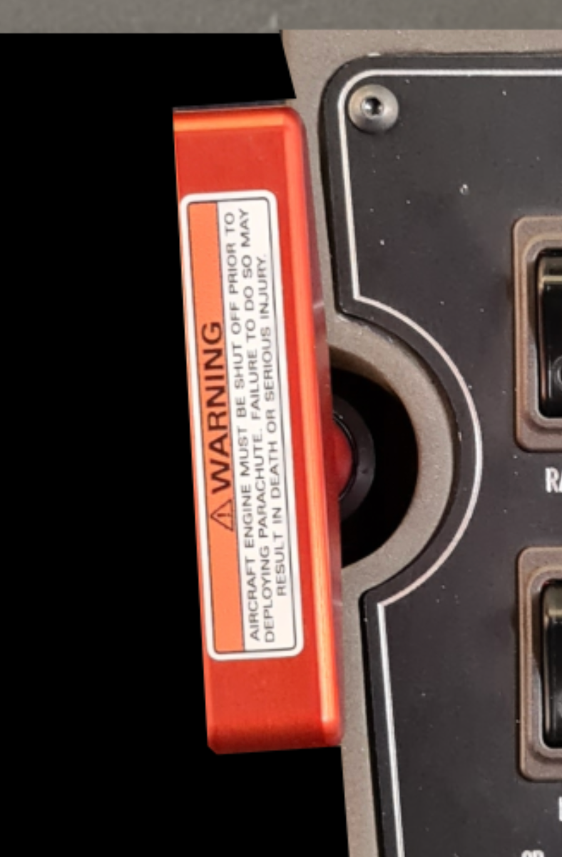

There is a warning placard on the fuselage of the aircraft at the egress point, and a different warning on the handle.
