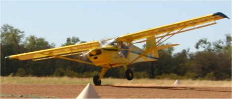

Guest John Mac Posted May 6, 2007 Posted May 6, 2007 It all about planning your arrival. Wing down into wind and keep it straight down the centre line with rudder. Here we have max Xwind with gusts -- Look well ahead and keep those feet relaxed and moving.
