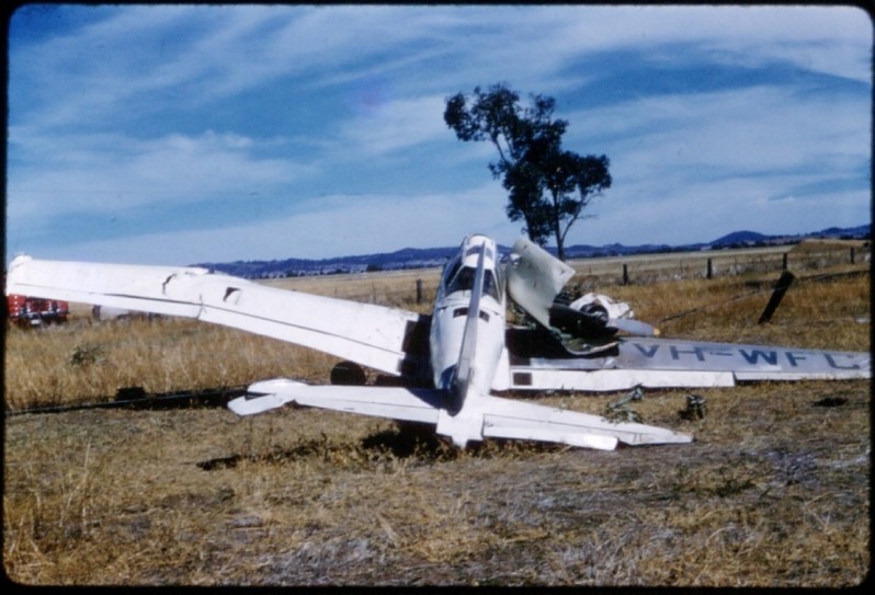

nong Posted June 12, 2012 Posted June 12, 2012 At least Kevin practices what he preaches. This is not a turn back attempt. EFATO training gone wrong at Forest Hill (Wagga) in April sixty two. Instructor Niel Whybrow and student Kevin Walters walked away. Jim G, maybe Kev could give you the full story over a beer one day. This shot shows the flight path with the runway threshold beyond the tree.. They flew straight into the tree then took out the telephone lines and landed on the railway with a neat one-eighty spin. The tree is still there. 2
