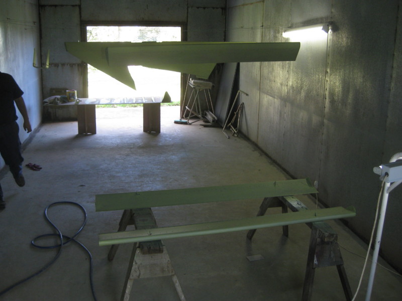

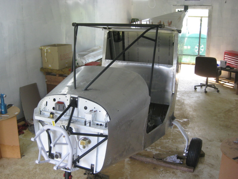

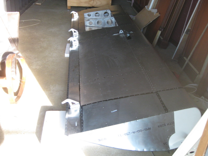

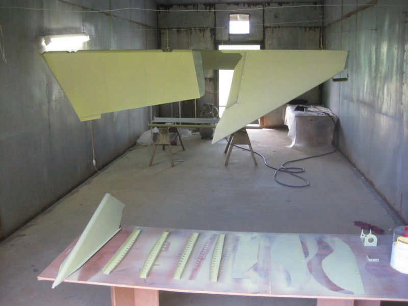

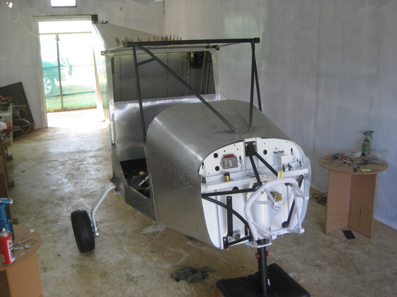

Hadyn Bell Posted October 11, 2012 Author Posted October 11, 2012 Just an update with some pics of where we are at....Still need to fit up the fuel tanks in the wings before they get painted. Other items are now painted and we are in the middle of priming up the other parts. Yes Mark you are correct that the visual progress starts slowing down at this stage but its nice to get some of those smaller jobs completed. The cabin frame fitted up really well, very happy with the measurements. Elevator push rod to "adjust" away from the tunnel, one just needs to hunt through the forum to find such consistent problems with other builds, also chat with Mark.... 1

Kyle Communications Posted October 11, 2012 Posted October 11, 2012 Hi Hadyn I see you mounted your regulator with the fins horizontal. The recommend way I was told was to mount it so the fins are vertical it makes access to the main plug you wire easier and shorter also the solenoid is a better fit for the battery cable if you turn it 180 deg also this puts the spade terminals that the wiring goes to at the front makes it easier to attach the spades onto otherwise it is difficult to get to them if they are behind the solenoid. These are only suggestions of course . This is the way I did mine from advice from other builders and on some that I had seen and it worked well Good progress too Mark

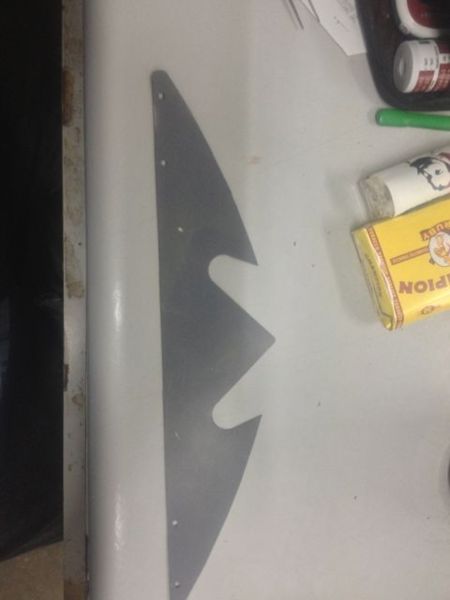

bobcharl Posted October 13, 2012 Posted October 13, 2012 Hadyn All appears to be going nicely. Would like some advice if you could please. Where the two forward members of the cabin frame enter the front fuselage and then bolt to the firewall/engine mount there appears to be two pieces used to cover in the opening. I have the rear piece, what covers the front of the hole? A part # would be great. I cannot find any reference to this in the manual. Thanks, Bob
Kyle Communications Posted October 13, 2012 Posted October 13, 2012 Bob it sort of looks like a small boomerang ....I didn't fit mine as I couldnt easily work out how it fitted the carpet covers the hole anyway. I think I have it here somewhere I will take a pic and post it for you
Hadyn Bell Posted October 14, 2012 Author Posted October 14, 2012 HadynAll appears to be going nicely. Would like some advice if you could please. Where the two forward members of the cabin frame enter the front fuselage and then bolt to the firewall/engine mount there appears to be two pieces used to cover in the opening. I have the rear piece, what covers the front of the hole? A part # would be great. I cannot find any reference to this in the manual. Thanks, Bob Hi Bob, There is only one piece supplied to cover the hole and as Mark said it didn't fit too well. I needed to modify it a little and then i made up a piece to fit over the front opening, probably shouldn't have as that is where the base of the screen sits but im sure i can deal with that, . As Mark also pointed out the carpet covers the hole.
eightyknots Posted October 14, 2012 Posted October 14, 2012 Hi Bob,There is only one piece supplied to cover the hole and as Mark said it didn't fit too well. I needed to modify it a little and then i made up a piece to fit over the front opening, probably shouldn't have as that is where the base of the screen sits but im sure i can deal with that, . As Mark also pointed out the carpet covers the hole. A weight saving, perhaps, by not using it? I understand then, it's not structural in any way?
bobcharl Posted October 15, 2012 Posted October 15, 2012 Thanks Hadyn and Mark, Had the piece in Marks pic sorted but as mentioned the fit-up is not the greatest, but was concerned that the front of the opening may not be covered completely by the screen and was actually starting to design a piece to cover the front as you have done Hadyn. Great minds must think alike. Bob

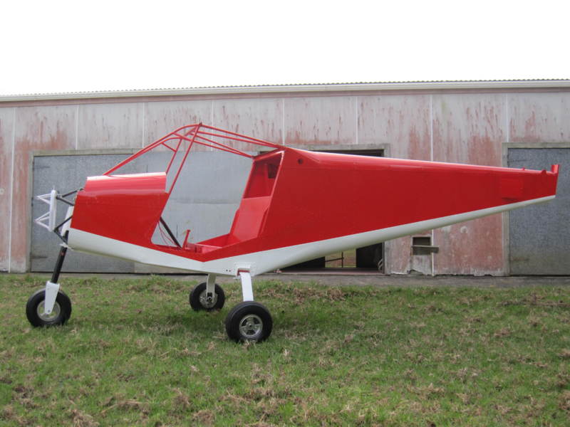

Hadyn Bell Posted April 6, 2013 Author Posted April 6, 2013 Hi All, Just to keep everyone up to speed, yes we have been working on our Sav even though our time working on her is a little less than we would like. Anyway we are happy with the progress and now that the fuselage is painted we can move on with a large list of things to do... 1
rankamateur Posted April 6, 2013 Posted April 6, 2013 Hang something heavy on the front before you fit the tail feather or it might tip up and bend something.

eightyknots Posted April 7, 2013 Posted April 7, 2013 Hi All,Just to keep everyone up to speed, yes we have been working on our Sav even though our time working on her is a little less than we would like. Anyway we are happy with the progress and now that the fuselage is painted we can move on with a large list of things to do... [ATTACH]21490[/ATTACH] After a few months' break, it's nice to hear from you again Hadyn! The paint job looks lovely. {how many kg did that add to the project weight though?}
